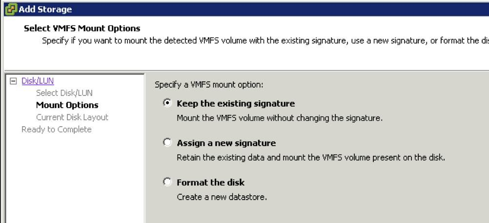

    I know this is an old thread, but I used it a lot to fix my own issue. If you are getting similar symptoms and the "magic number" error, please check to make sure you haven't taken a snapshot on your SAN. I'm running ZFS and took a snapshot of the zvol containing my datastore. This is the output I got in the vmkernel log when trying to rescan the storage adapter:
    [root@ESXI:~] tail /var/log/vmkernel.log
    2015-08-28T02:35:57.160Z cpu4:33159)NMP: nmp_ResetDeviceLogThrottling:3345: last error status from device mpx.vmhba32:C0:T0:L0 repeated 19 times
    2015-08-28T02:37:40.649Z cpu6:32797)NMP: nmp_ThrottleLogForDevice:3178: Cmd 0x9e (0x439d806e13c0, 0) to dev "mpx.vmhba32:C0:T0:L0" on path "vmhba32:C0:T0:L0" Failed: H:0x0 D:0x2 P:0x0 Valid sense data: 0x5 0x20 0x0. Act:NONE
    2015-08-28T02:37:40.717Z cpu0:43827)LVM: 10060: Device naa.6589cfc000000903f337f92db5f049d3:1 detected to be a snapshot:
    2015-08-28T02:37:40.717Z cpu0:43827)LVM: 10067:   queried disk ID: <type 1, len 21, lun 0, devType 0, scsi 0, h(id) 13996138677875135599>
    2015-08-28T02:37:40.717Z cpu0:43827)LVM: 10074:   on-disk disk ID: <type 1, len 21, lun 0, devType 0, scsi 0, h(id) 1294898510287430916>
    2015-08-28T02:37:40.822Z cpu6:32797)NMP: nmp_ThrottleLogForDevice:3130: last error status from device mpx.vmhba32:C0:T0:L0 repeated 10 times
    2015-08-28T02:37:40.922Z cpu0:43827)FSS: 5327: No FS driver claimed device 'control': No filesystem on the device
    2015-08-28T02:37:40.923Z cpu0:43827)VC: 3551: Device rescan time 77 msec (total number of devices 6)
    2015-08-28T02:37:40.923Z cpu0:43827)VC: 3554: Filesystem probe time 205 msec (devices probed 5 of 6)
    2015-08-28T02:37:40.923Z cpu0:43827)VC: 3556: Refresh open volume time 1 msec
    If you see this, you need to resignature the datastore. I didn't lose anything when I did the resig using the "Keep existing signature" option under "Add storage".
    If you took a snapshot, and are not seeing the "detected to be a snapshot", let me know. There were a couple other settings I messed with on the FreeNAS extent like the compatibility setting, but I'm not sure whether or not it had an effect. Also, I'm in the middle of a recovery from a messed up pool configuration, so the proper fix is probably to delete the snapshots. I just need to access them again to back them up.
