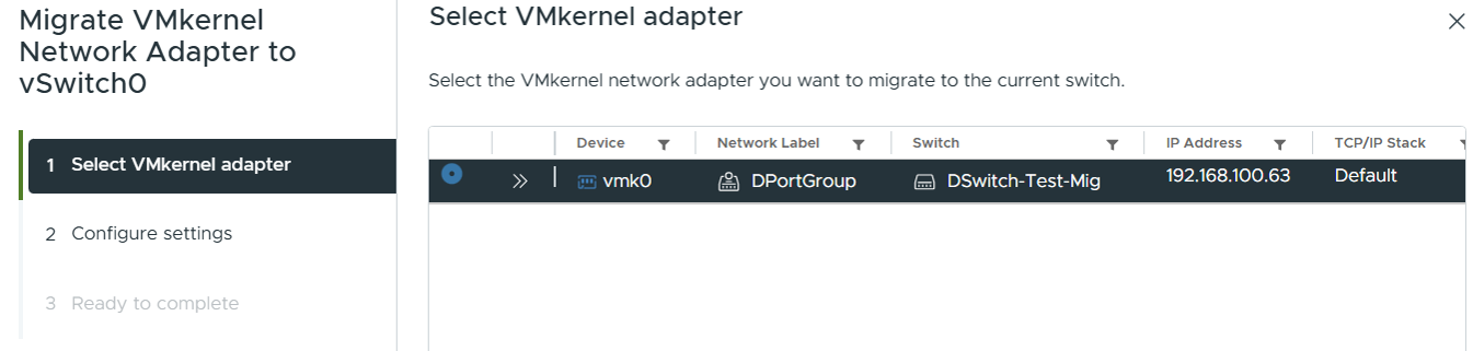

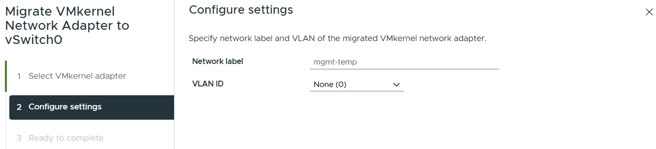

    5. Use the "Migrate VMkernel to another network" wizard from the new VSS and select vmk0. When prompted for a port group, name it mgmt-temp (or whatever you prefer), and tag it with the corresponding VLAN if needed
    6. At this point, management is running on vmnic1 via the VSS. Now, you can remove vmnic0 from the vDS and assign it to the VSS for redundancy.
