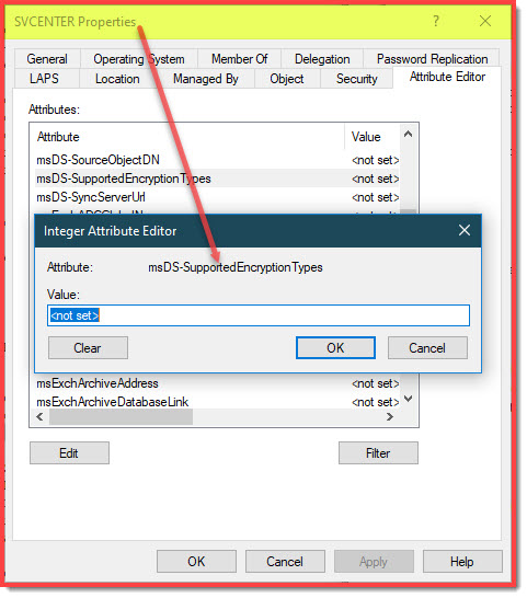

    So I wonder? Does the msDS-SupportedEncryptionTypes computer object attribute need to be defined? Shown next is the Active Directory Users and Computers SVCENTER computer object property:
