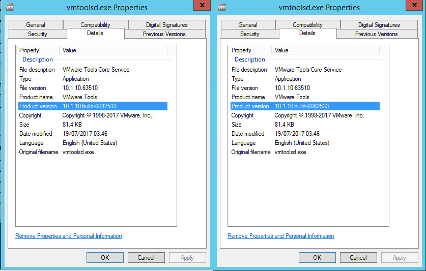

    I haven't, however being a work environment I don't believe I have the access to do so.
    The vmware tools version is the same as other guests that I'm able to connect to with RDP.
