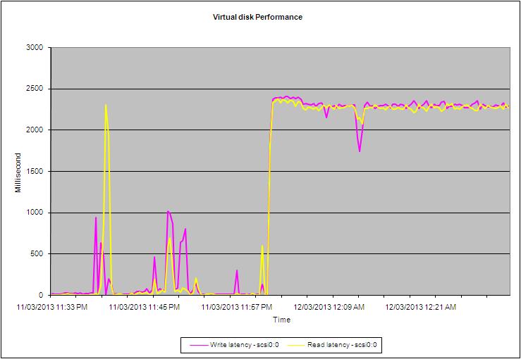

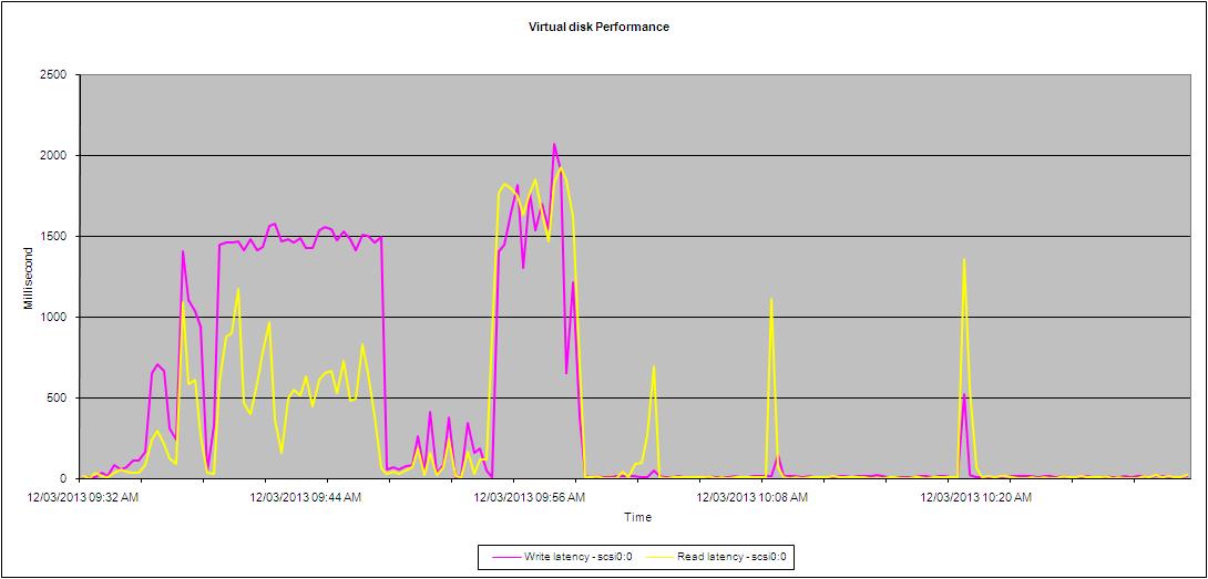

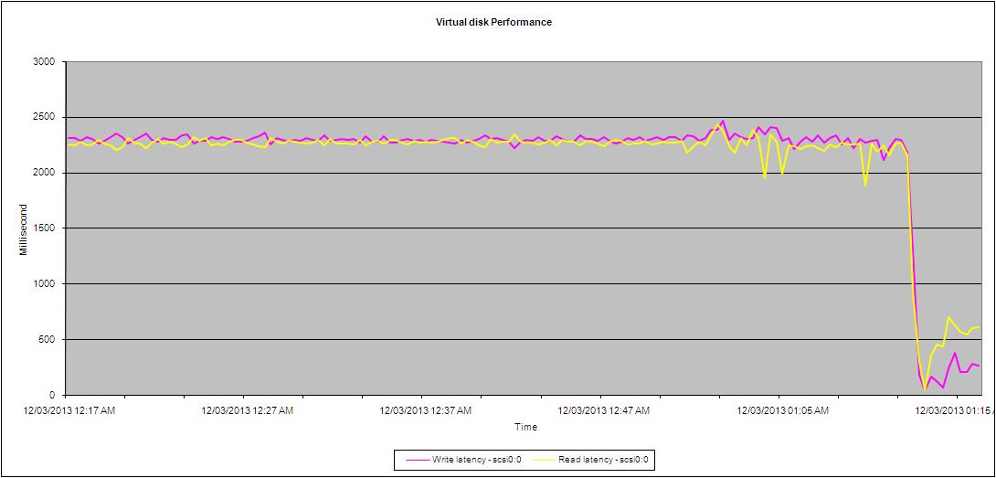

    Here are some screen shots of the performance charts:
    During During peak usage it's impossible to run our software, it gets really slow. The server never hangs, after a while (First it was 10-15 min, now up to1 hour) performance returns back to normal.
