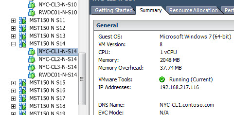

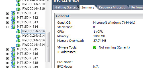

    I need to amend my original post.  Most of the time, the VMtools say "not running" (see image).
    I have found the only way to get them running again is to connect using vSphere client, open the console and click in the console screen.  After this the VMtools say "running" and I can connect to the VM using RDP.  (See image)
    Any ideas what causes this?  Would Horizon View be a solution to this?

  • 6.  RE: RDP and VMTools issues
    Posted Aug 29, 2013 06:45 AM
    May be windows is putting the 'computer' to sleep. Can you disable the sleepState and check whether your seeing this issue.
