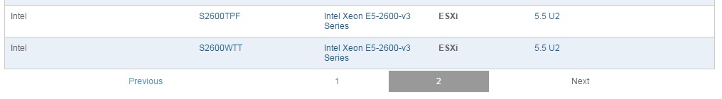

    Did you confirm the Motherboard on VMware's Hardware Compatability List?
  • 3.  RE: Problem with s2600wtt
    Posted Jan 13, 2015 03:50 PM
    Andrea ,
    Please check if you using the compatible model of hardware to install esxi .
    VMware Compatibility Guide: System Search
    Also try the steps mentioned in the below thread.
    Re: Loading ESXi installer issue " Relocating modules and starting up the kernel"
    Thanks

    your board is supported though
    i think it might be other hardware
    bad memory module, raid controller card, vga card,bad power supply,etc....
