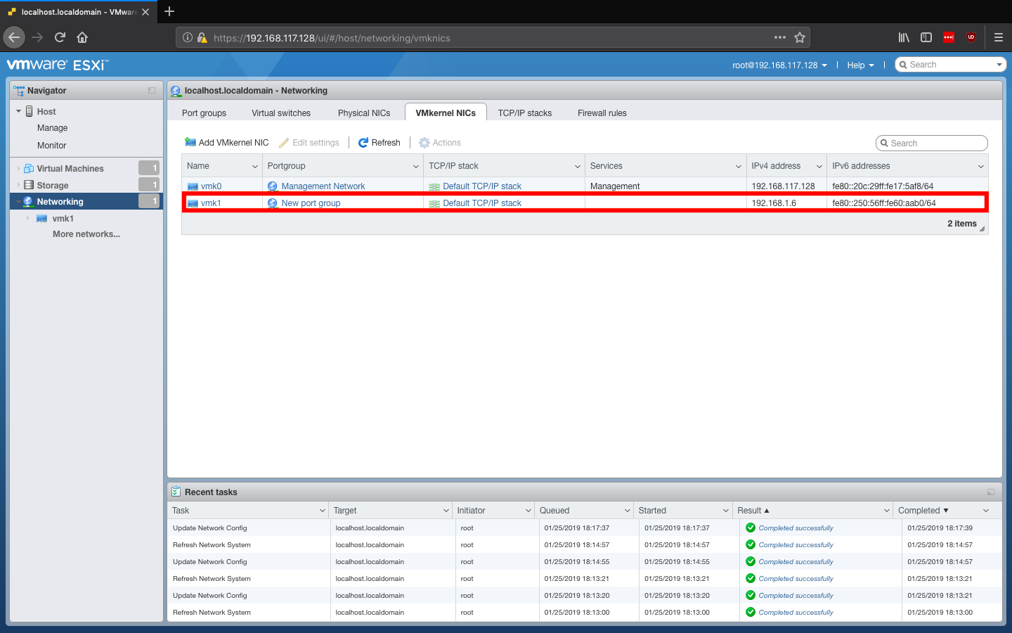

    I've been following here, in order to get 2 subnets working on ESxi 6, you must put VMKernal Nic in "VM Network"port group, however only when i put it in a new port group i created does it actually reflect the external network:  Is this right?
    In ether case, the source i can select when editing VM setting is "VM Network" which wouldn't equal to 2nd screenshot.
    What am I missing..?

    Dear TECH198​ You need to understand the difference in VMK and VMnetwork, whenever we have a network where ESXi will communicate as its own identity we create VMkernal port group which has a IP assigned, that IP will represent ESXi in that network.
    Now VM network is a subnet on which Virtual machines will be communicating, hence it doesnt have a VMK, as IP will be assigned to the NIC card of the VM.
    Now, if you want 2 subnets VMs to talk to each other then, add vm network port group with (vLan ID), and these vLans should be route able.

    It took me ages to get this to work but the solution ended up be very simple.. All i needed was ad a second uplink.
    No port groups or anything,, just add uplink..
    However, i think now know why it was recommended to set as "bridged" mode. I tried to use NAT, to use Mac's internet connection along with Host only, and had Windows issues on reboot. it lost connection, but the moment disables adapter 1 from device manager, internet started working again, so i changed second NIC in Esxi to "Bridged" and cleared that up.
