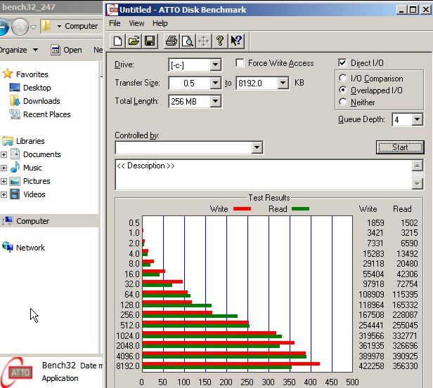

    I have setup two ESXi 5 box , version 5.0.0.914586, 1 installed with nexenta on a VM with RDM, the other just run typical windows VMs
    Disks Performance is great when running VM on this nexenta box as shown in the following benchmark

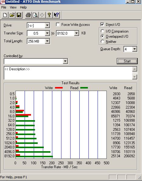

    However, on the second ESXi box tried to run the same test via iscsi, the result is terrible as shown below
    If you look at 16K blocks, it is still acceptable as it writes around 40MB/s,
    However, it dramatically drops to 1215kb when trying to write 32K block?
    Does anyone know why? Or tell me how to troubleshoot this issue

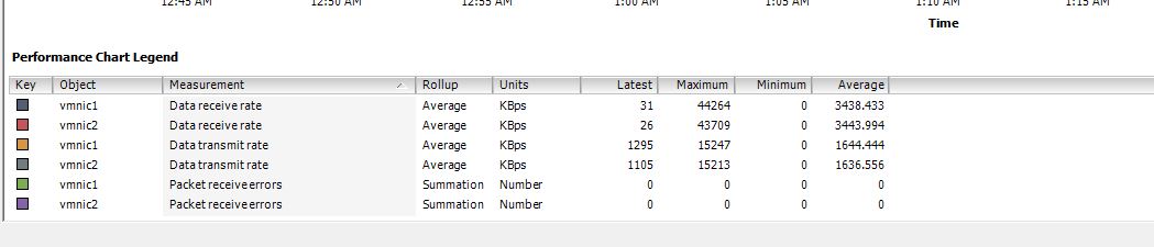

    Network statistics when running 32k block size test
