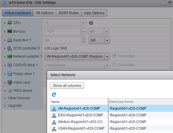

    I know this should be easy but when I set these permissions the user can't see the DISTRIBUTED SWITCH options in edit settings for VM's.

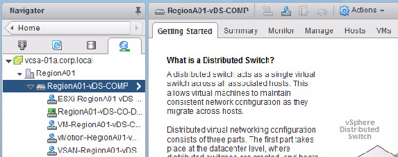

    For a user to change network settings of a VM or for user to change Distributed Switch configuration?
    I've tried the same settings and the user is able to change the network settings of a VM selecting a Distributed Switch PortGroup
    Make sure to assign the user permission at the ​Datacenter​ level

    Assigning at the datacenter level should not be a requirement.  Vsphere explicitly states that VDS permissions can be assigned at the datacenter level or a folder containing the VDS.  We need to do the latter to limit permissions to a subset of our VMs.

    I haven't tried assigning permission on the folder level, but as a workaround you can still assign on datacenter level then assign 'No Access' on other folder for that user/user group or other VMs so the user/user group would only see the VMs without 'No Access'

    BIt of an old post but I've just come across this situation and had a bit of a play around with it.
    Assuming the user has permissions to modify the VM...
    1. If the user also has access to just the portGroup or a Network Folder ('assign network' permissions), they will be able to add a new network adapter and select the desired portGroup.
    2. If the user also has access to just the portGroup or a Network Folder ('assign network' permissions), they will not be able to modify an existing network adapter and assign it to a different port group. For this to work, the user needs read-only access to the host (or cluster) where the VM is located.
    I guess the process of modifying a network adapter must query the host to see which portGroups it can access, while adding a new network adapter does not. The KB suggests giving access at the Datacenter level, which would in turn give access to the Cluster/Host.
