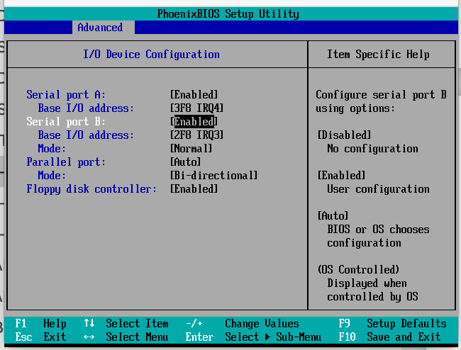

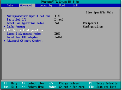

    Is the VM virtual firmware using BIOS or EFI? If it is using BIOS, the default is that COM1: and COM2: are enabled in the virtual BIOS. What are the serial COM assignments for the MOXA ports? Either change the MOXA serial port assignment (maybe change it to COM3:, COM4:, etc) or disable the serial ports in the virtual BIOS (if VM is using BIOS).
    You can refer to this KB on how to enter the virtual BIOS. Using the bios.forceSetupOnce = "TRUE" works also for ESXi VMs.
    https://kb.vmware.com/kb/1004129
    I have pasted two screenshots from the virtual BIOS from Fusion (should be same for ESXi VMs). Go to the Advanced and I/O Device configuration and you can disable the serial A and serial B. In the screenshot of serial A and B, I made it as "Enabled" to be obvious but the default is "Auto". There should be a "Disable" option. I don't think there is any serial setting is the virtual firmware is EFI.
