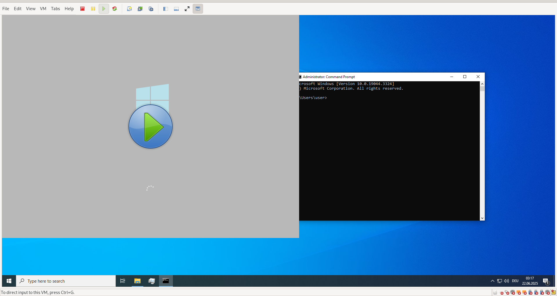

    If the Guest has 3d acceleration enabled, the "pause overlay" won't go away, even though the VM itself is unpaused.
    If the guest does not use 3d acceleration, this issue does not exist.
    Here is a screenshot, the pause overlay is smaller because I paused-and-unpaused the VM during boot where the screen size was still 640×480 (or similar).

    1. Can you please take a screenshot by going to VM->capture screen and check if it has the full window?
    2. Can you please put this config option mks.enableVulkanPresentation=FALSE and see if that changes anything? Also do a capture screen.
  • 8.  RE: Pause overlay doesn't go away on unpause
    Posted Jun 25, 2025 04:49 AM
    Yes, the screenshot has the full window. No, enableVulkanPresentation=FALSE does not change anything.
    When I close the workstation window (+ let the VM run in the background), then reopen the window, it also shows the full window. It's not enough to just switch between different tabs though.
    If you need a specific log file, please tell me which one (what path) and how to share, and I will happily do so. Thank you!

    Can you run `xwininfo -tree` and click on the pause overlay then share the results here. This will show the window tree of the overlay, its parent and its children.

    Thanks for doing the experiments. Are you using X11 or wayland? If you switch the session type to X11 does it make it better?
    For the logs, can you please attach vmware.log and mksSandbox.log from VM directory and then UI log from /tmp/vmware-<user_name>/vmware-ui-*.logs

    I am using X11, i3wm. I tested this on X11 gnome-shell too, to rule out this being (yet another) i3 bug. Had the exact same issue there. (The screenshot in OP is actually from when I was using gnome-shell). I have uploaded the logs and xwininfo outputs here:
    https://send.aurorabilisim.com/download/17972af4179e6b7b/#abuHbM7DyFezb2RlA4xyKw
