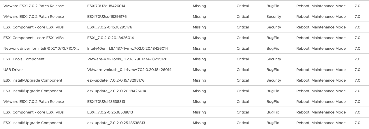

    The Server has been upgraded via VUM however I still see 12 critical and 5 Security patches pending, what is the correct process to update this custom image so it includes this patches and is it recommended to do so since its a Customized vendor image?
    This should not change any drivers as they have already been validated via the HCL
    Thanks

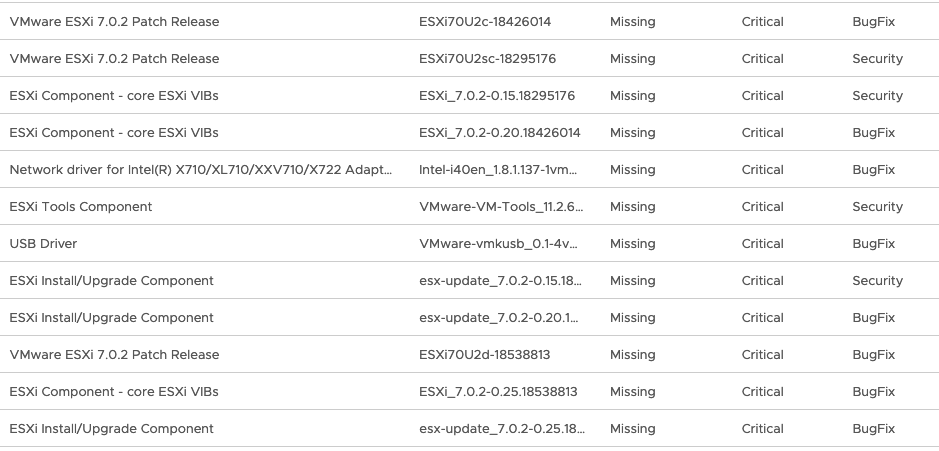

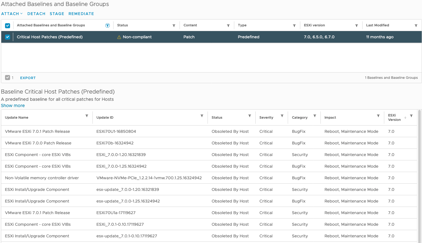

    Ok so do I select Critical Host Patches (Predefined), click STAGE and REMEDIATE and it will auto pickup the Missing (Shown under Status) critical updates?
    Which Baselines should normally be attached - The Critical Host Patches and the Host Security Patches (Both Predefined)?
    In this case the following are the ones showing as "Missing", I see core ESXi VIBs and this is perfectly ok to do right as sometimes in past I got vib conflicts events?

    1- Yes, or create the Baseline with the patch you want to install.

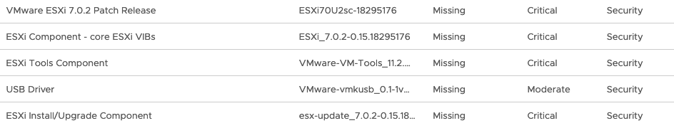

    1) yes creating a Baseline sounds good to include just the needed Critical and Security Patches, should I select all the Updates that show "Missing" under Status or can I just select one that would include all?
    Critical
    Security
    2) Installed via VUM as suggested image was a customized Esxi image from Dell (I did not upload anything to VUM however)

    1- you can select the one that includes all.
    2 -You need to install the Dell customized major releases. While for security patches you can use those released by vmware.
    From VUM select only the patch you are interested in.
    ARomeo

    Ok created and using a baseline that includes the Dell Custom image for ESXi 7.0 Update 2a, which image was already available in VUM.
    For the rest it was not clear which update I should include from the Security and Critical patches so I did not add to Baseline
