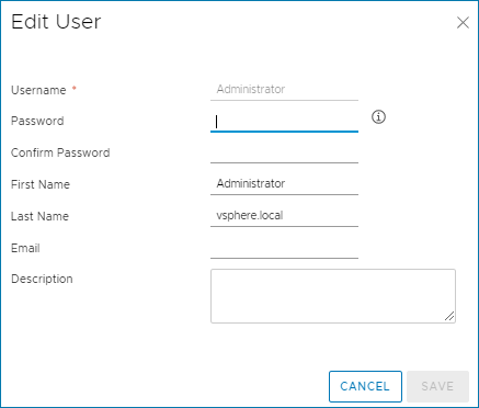

    How we can get an email notification vCenter Server of "administrator@vsphere.local" password expiration notification via email? I have set and email address on the 'administrator@vsphere.local' but not getting mail notification.It's only notification on VC bar once i'm login.
    Mail notification only working for OS "root".

    How about if i create a new local user something like "used01@vsphere.local".
    I have test and it's expired, my question how I enable the notification via email instead of pop-up in the top bar once this id log-in.

    When you create local users, they have email value. Did you try to fill in this value, configure SMTP Server on vCenter and catch some event by vCenter Alarm or SNMP trap?

    Hi Koc
    I did input the email address but nothing email to me 30 days before the password expired. Out VC was configured mail relay to our smtp.
