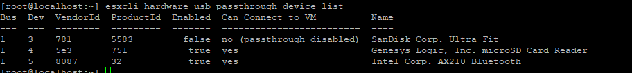

    I too am having issues passing an Intel AX210/AX200 to Win and Linux VMs and I believe I have narrowed the issue down to the fact the Intel driver is expecting the wifi chip and the USB Bluetooth.
    I have tried passing both to a VM but no luck.
    So it looks like ESXI needs to fully release the USB part of the AX2xx cards and be able to PCI passthrough or the Intel drivers needs to continue loading even if the thee USB Bluetooth is missing.
    Any ideas on how to get ESXI not to pick up the USB Bluetooth and pass it through as a PCI device?
