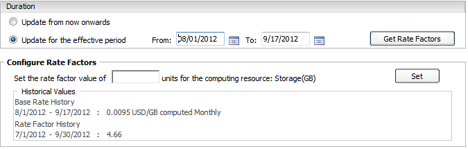

    Base rate and rate factors for Tier3, Tier2, Tier1
    It doesn't seem wrong, isn't? And creation dates of datastores are old enough.
    I don't know what to do. Thank you for the answer.
