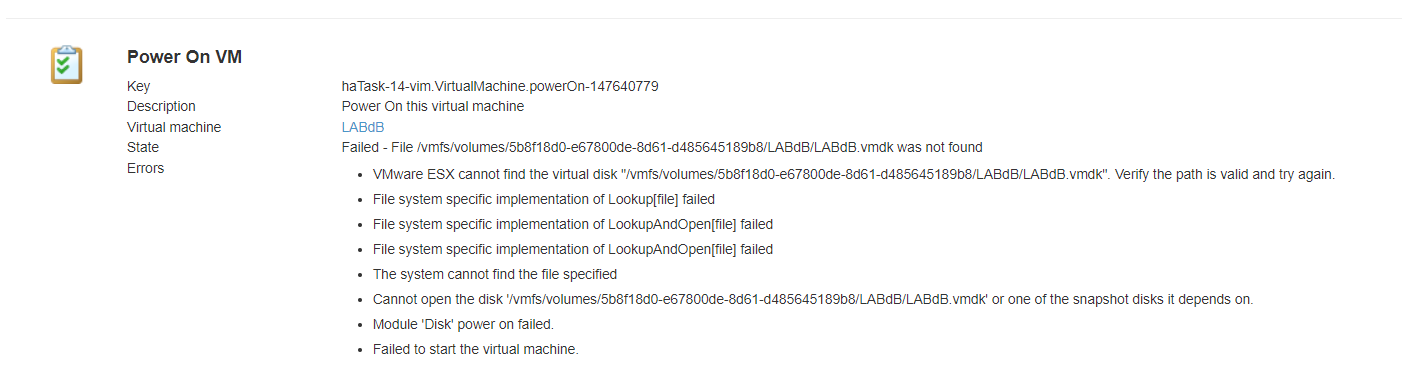

    I was able to register 2 of them and power them on successfully, however the 3rd one is throwing the following error
    any help would be appreciated

    Ok.. i realized my .vmdk file was not in the right folder.
    so my issue now is it keeps coming up with operating system not found.. and it was working before

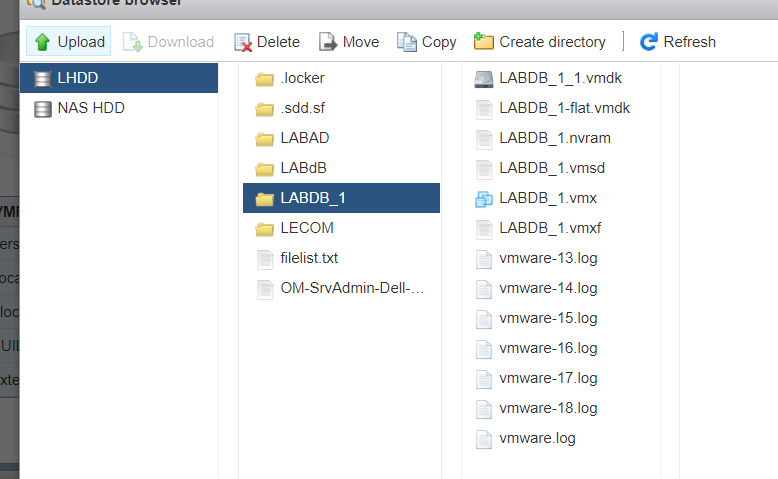

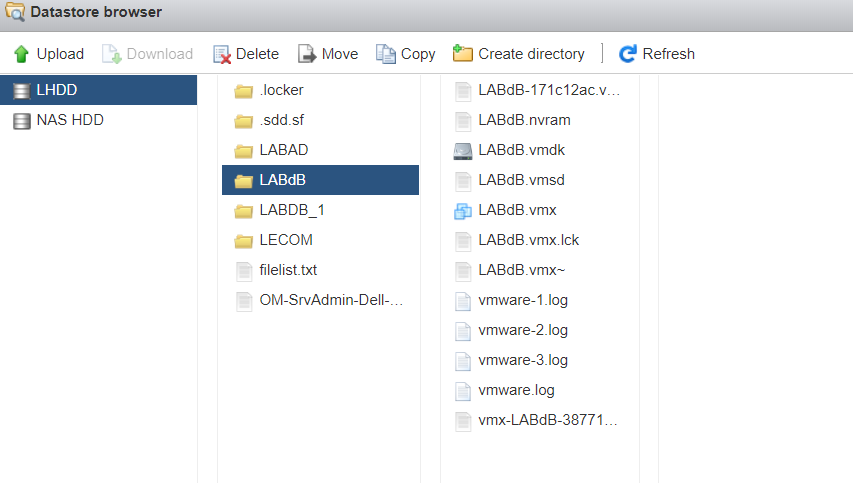

    also when the VM was running fine 100GB disk was under the LABdb folder and 400GB 2nd hard-disk for some reason was put into a 2nd folder LABDB_1.. as shown below

    Please don't mind me asking, but can you confirm that both "LABdB" VMs ("LABdB" as well as "LABDB_1") should be working?
    To me it looks like "LABdB" has been created, and then removed from the inventory (but not deleted from disk). Then a new "LABDB_1" VM has been created, which is the correvt one.

    LABdB" is the correct one... with a 100 GB hard-drive which was my C: drive
    after a few months, i wanted to create a 2nd HDD..400 GB - D: drive.. but  for some reason it created a 2nd folder "LABDB_1" and put the 400 GB .vmdk over there.
    attached though is the .vmx file from the LABDB_1 folder
    I have tried to remove/unregister from the inventory a few times and add back in.. but did not work

    does it make sense to have a .vmx file for one VM across two folders?
    Not in this case. It's just confusing ...
    From what you provided so far:
    • Folder "LABdB" contains one virtual disk "LABdB" (100GB)
    • Folder "LABDB_1" contains two virtual disks "LABDB_1" (100GB), and "LABDB_1_1" (400GB)
    • The descriptor/header file for the 100GB virtual disk "LABDB_1" is missing (but the flat file has was in use until Aug, 2nd)!?
    What I would do in this case is to recreate the missing descriptor file, then modify both VMs, so that each of them only has the 100GB .vmdk file in its own folder mapped (no cross connect), and see which one of them boots. Then remove the wrong one from the inventory, and add the 400GB virtual disk to the working VM.
    Depending on which files are the used, you (we) may want to do some cleanup, i.e. move the used files into a single folder, and remove the wrong one.
    Make sure that you do not accidentally select "delete from disk" when you unmap a virtual disk from a VM.
