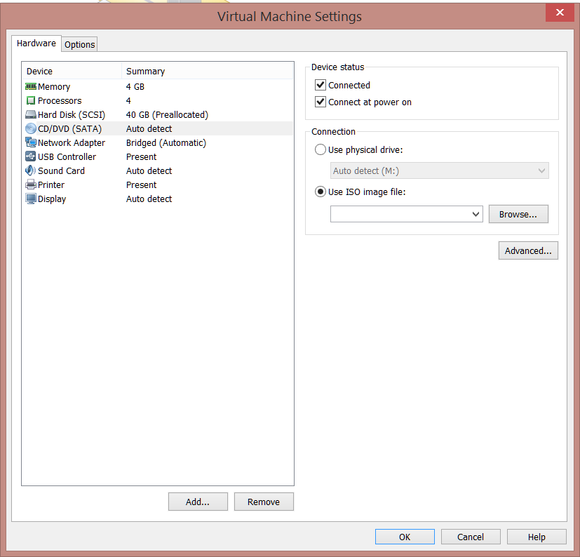

  • 15.  RE: Operating system not found
    Posted May 27, 2014 01:22 AM
    You should see something like this when opening virtual machine settings:
    (select CD\DVD drive and in the top right corner you have the options you are looking for)

    Posted Mar 16, 2015 01:59 AM
    I have tick the checkbox "Connect at power on" but the checkbox "Connected" is disabled.
    But window cannot start and the machine is going to boot fron network.
    Please suggest some help...
  • 17.  RE: Operating system not found
    Posted Mar 16, 2015 07:56 AM
    Tick box "Connected" is grayed out if the VM is powered off.
    So this is normal.
    Please check vGeek: VM settings: CD/DVD drive
    Try the workaround described in "How to configure "Client Device"
    So connect the ISO from the Console Window's icon bar.
    And set the boot delay to for example 10 seconds seeing what exactly the VM is doing with the attached ISO.
    Go into the BIOS inside the VM and check the boot order there (like on a physical machine).
    Make sure the CD/DVD is on top.
