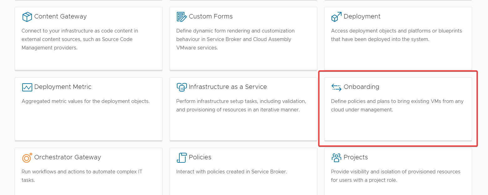

  • 4.  RE: Onboarding api - Add vm's to plan
    Posted Nov 03, 2022 08:03 PM
    Hmm...I see the Onboarding section in our on-prem API docs (8.4.2) as well as in the SaaS offering.  Seems odd that it would be missing for just 8.9.
    Are you hitting this link for the swagger docs?  <your vra site>/automation-ui/api-docs/
    You should see something this....
  • 5.  RE: Onboarding api - Add vm's to plan
    Posted Nov 03, 2022 08:08 PM
    Yep that's where I'm at.  This is what I see.
    https://www.mgmt.cloud.vmware.com/relocation/api/swagger/ui/index.html

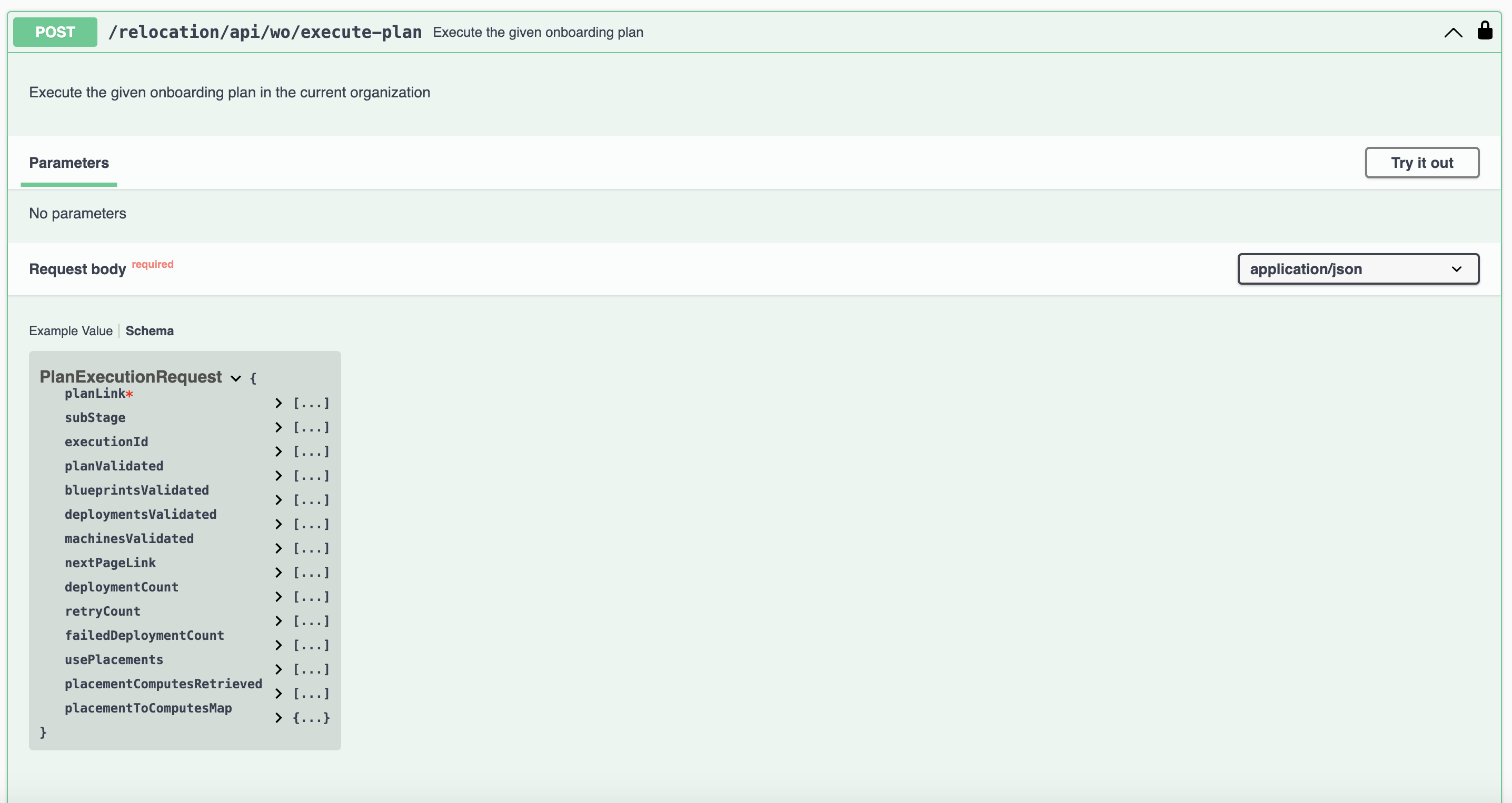

    I would like to understand better how Run a plan works: relocation/api/wo/execute-plan.
    According to the documentation, it seems planLink is the mandatory field:
    Execute the given onboarding plan
    Is this correct?

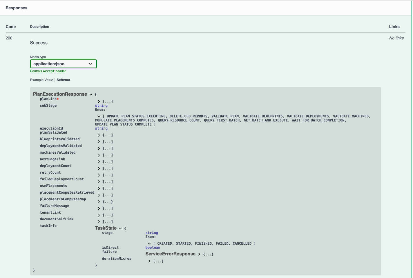

    I have tested this and the plan is run but sometimes I get errors like "RuntimeException: Validation failed". Do you know how validation works?
    If I wanted to check if the execute-plan has finished properly, what should I check? subStage, taskInfo?
    subStage fields has 12 different values and taskInfo also has 5 different stages as shown below:
    PlanExecutionResponse schema
    An additional question: Do I have to use /relocation/api/wo/execute-plan/{id} after calling execute-plan to check if the process finished properly?
    I would appreciate any comments on this.
