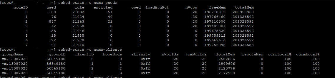

    I have a VM with 64 vCPUs and 512GB RAM, it’s a massive db. ESXi 6.5 are HP DL560 with 4 sockets (22 cores each + HT) and 1.5 TB RAM. According to Frank Denneman's book vSphere 6.5 Host Resources Deep Dive I aimed at keeping the VPD onto as little psockets as possible. By disabling the Hot add CPU feature and by adding the preferHT set to True I increased performance quite a lot and I expected to see cores spread onto two physical sockets. However while the VMWare KB 2003582 states how to implement the preferHT setting it does not mention something Frank Denneman did say in his book:

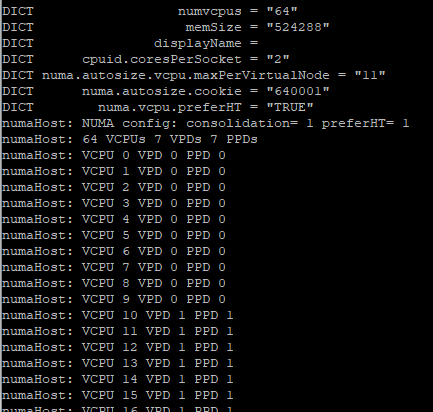

    I read the above after I did the initial changes to the VM and I have now noticed that its numa.autosize.vcpu.maxPerVirtualNode value is 11. According to Virtual NUMA Controls I should get 6 virtual nodes by dividing 64 by 11,but I see the VM has 7. This is another thing I don't understand.
    following which criteria do I adjust numa.autosize.vcpu.maxPerVirtualNode value?
    Shall I set it to 44 as it is the max number of logical cores in a physical socket? Or shall I disable it and let the system do its best decision? If yes how do I disable it? This is the current layout of the cpu resources of the vm:
    although performances have improved I’m not happy with the distribution of the cores. Specially considering that homeNode 3 is not used at all.

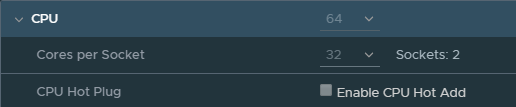

    PreferHT is used to consolidate the vCPUs as much as possible and create the fewest number of NUMA clients. In your situation, there are four NUMA nodes, 22 cores with each 384 GB of memory (assuming the DIMMs are equally distributed across sockets and offer the same capacity). With PreferHT, the NUMA scheduler takes the SMT capabilities into account, and therefore, each NUMA node can now accept NUMA clients similar to the HT thread count. In your situation, that is 44.
    With this theory, your VM of 64 vCPUs should be distributed across two NUMA clients, each NUMA client grouping 32 vCPUs.
    The advice of setting numa.autosize.vcpu.maxPerVirtualNode in the book is to propagate the virtual NUMA topology to the guest OS. This is typically recommended for VMs that exceed the memory capacity of a NUMA node while being able to all the vCPUs in a single NUMA node. In your scenario, setting it to 11 restricts the scheduler to prefer HT threads for sizing the NUMA client. 64/11 = 5.8; thus, it should round up to 6, but it doesn't do this, so I expect other advanced settings are influencing the NUMA client configuration.
    Instead of diving into and wasting much time on figuring out this anomaly, my recommendation is to remove the setting numa.autosize.vcpu.maxPerVirtualNode, and allow the NUMA scheduler to align the NUMA client configuration to the PreferHT setting. Typically most customers do not use PreferHT on a virtual machine that has that many CPUs. PreferHT is an advanced setting designed to help workloads that are cache-intensive, but not CPU intensive. By scheduling all the vCPUs into the same NUMA node, it can leverage the same L1/L2/L3 cache and thus take advantage of the spatial locality of memory access. I suspect, you assigning 64 vCPUs is to have a lot of CPU resources available for the application.
    We decoupled the NUMA scheduling constructs from the user setting Cores per Socket (CPS). Thus the setting provides customers to align with licensing requirements while the NUMA scheduler can manage its constructs to optimize memory access. When setting it, it provides a socket topology, and the Guest OS translates that as cache scheduling domains. In your situation, with 64 vCPUs with PreferHT enabled and maxPerVirtualNode disabled, you should get two NUMA clients with each containing 32 vCPUs. Your CPS setting should be 32 cores per Socket. That will present a dual-socket configuration, and your Guest OS will create a Cache map, where 32 CPUs share the same cache. The application and Guest OS can now determine where to place the threads when they expect these threads to share and access the same memory blocks.

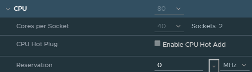

    Hello again, I could not get the authorization to shutdown the VM but I did for another VM, and so I could test these settings. The VM at hand has 80 vCPUs/1.3TB RAM and the Hot Adds enabled (CPU/RAM). After having shutdown the VM I did the following:
    1. disabled both Hot adds features
    2. decreased RAM to 312 GB to suit its real consumption (roughly 150/200 GB)
    2. added the numa.vcpu.preferHT=TRUE parameter
    3. removed the numa.autosize.vcpu.maxPerVirtualNode parameter
    4. adjusted the CPU sockets/Cores as per screenshot:
    I turned on the VM but I see that the numa.autosize.vcpu.maxPerVirtualNode parameter was recreated with a value of 20. I was expecting to see 40 vCPU on two physical sockets. Can anybody tell me if that is normal?

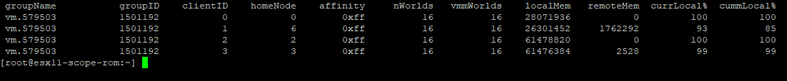

    FDenneman01 I finally had the green light to shutdown that VM for maintenance. Here's its cpu situation:

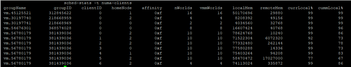

    and after the shut down I removed the numa.autosize.vcpu.maxPerVirtualNode as the preferHT is in place. When powered on I got this situation:
    once again the numa.autosize.vcpu.maxPerVirtualNode is back and its value is 16. So again the vCPUs are spread over all 4 physical cores, in spite of the preferHT and coresPerSocket. Is this something to address to VMware support? Or something I don't understand. I read about the preferHT:
