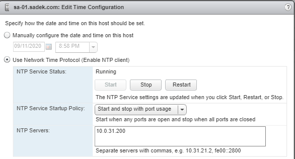

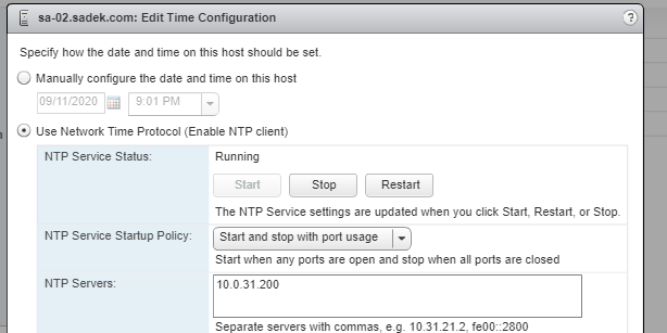

    Thanks much , i configured ntp on windows server and added it to vcsa and 2 hosts and it worked fine
    but  i notice that there's a difference like 3 min between host one and host two , i stop and start NTP service on both hosts but still there is difference in minutes even i added the same ntp server on both.
    so is this normal ?

    can you please share a screenshot of the NTP configurtation on both hosts?
    are all on the same network?
  • 6.  RE: NTP-Active Directory synchronization
    Posted Sep 11, 2020 07:05 PM
    yes sir,
    They all on same vlan and same network gateway
    check the screen shot for ntp configuration on two hosts ,
    host : sa-01
    host sa-02
