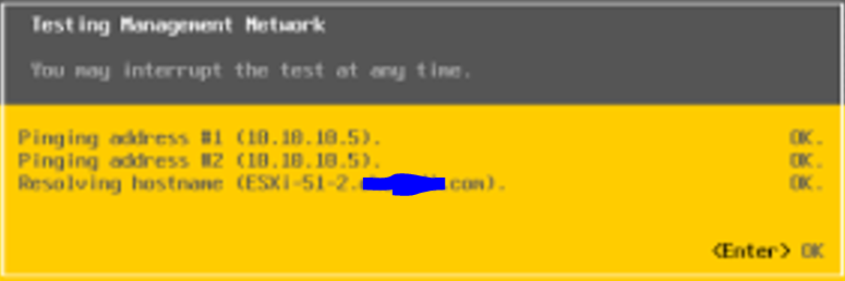

    Did you made any recent changes to host ? Try some primary troubleshooting steps :
    1. Ping Host name from vCenter with IP address and Host Name both. It should be reachable via both.
    2. Check ESXI host is connecting directly through vSphere Client.
    3. Make sure host network configuration is correct and unique.
           System Customization > Configure management network : Make sure IP address and Host name is unique. Also add DNS suffix there
           System Customization >  Test Management Network :  After network configuration, run this test to ensure your configuration is valid and correct.
