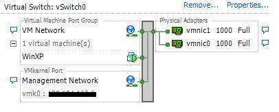

    Yes.
    See the screenshot:
    http://i263.photobucket.com/albums/ii139/CNBarnes/Work/WinXP.jpg

    I can do better than ping the service console - I can use vSphere to connect to it.
    (hint:  all the screenshots...)
    That means
    A) network TO the esxi machine is working fine
    b) network within the vm is fine
    leaving:  network between esxi and the vm is where it's hosed....

    Are you using a managed physical switch? If yes, check if the VM's MAC address is seen on one of the uplink ports.
    Are the Management network and the VM using the same IP subnet? What you could probably try (if possible) is to create another vSwitch and attach the XP VM to this one to see whether there is an issue with the VM and the Management network on the same vSwitch.

    Someone else suggested we look at the switch.   Turns out the management was set to not allow multiple IP's per port  (i have no idea how it was working before).    Changing that setting allowed the vm to magically start having network traffic.
