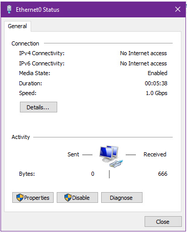

    Hi,
    Well, i installed a windows VM on my EXSi. The EXSi is running on a dedicated server, and i don't have internet access on my VM. I don't understand why, and i don't know what to do. I tried a lot of things but nothing work..

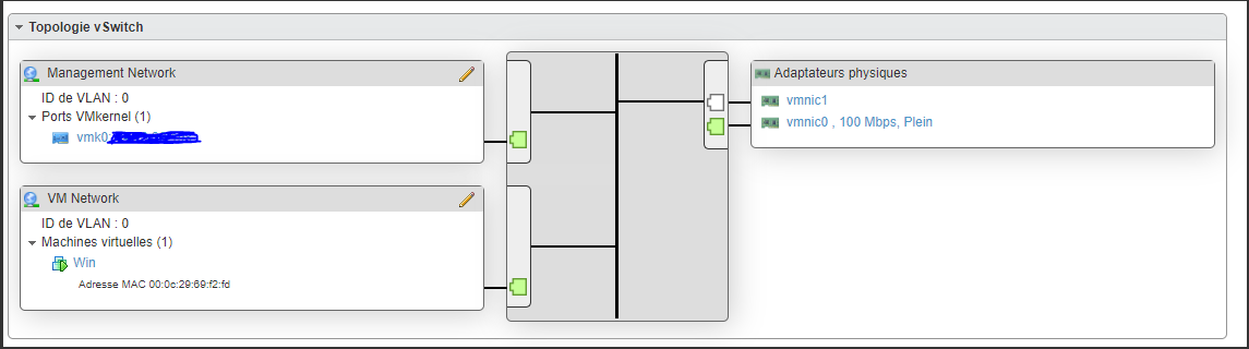

    It looks like this
    I'm using VM Network on my VM.
    Edited by moderator: Grayed out the ESXi host's public IP address.

    Assuming that you don't have a DHCP server available, did you assign fixed IP settings to the Windows 10 VM? The Win10 VM - like the ESXi host itself - needs it's own dedicated IP address in order to access the network.
    André
