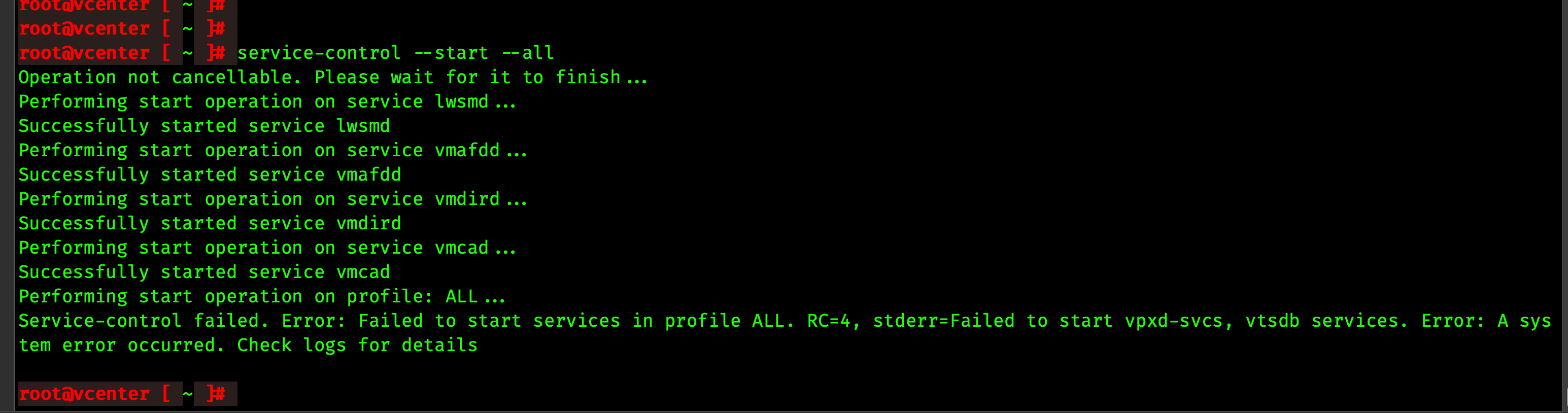

    When I try and start them using service-control I get some started then an error.
    I'd greatly appreciate any tips or guidance.    Thanks!

    About the logs.     service-control --start --all   stops and errors while trying to start vpxd-svcs so I've cat and less that log , grepped for error and other things but honestly, I have no idea what I'm looking for and while I do see some errors I don't know what is relevant.
    I've zipped and attached the current vpxd & vpxd-svcs log files.  I would greatly appreciate another set of eyes on them if that is the proper direction to go or any other guidance.     Thanks folks!

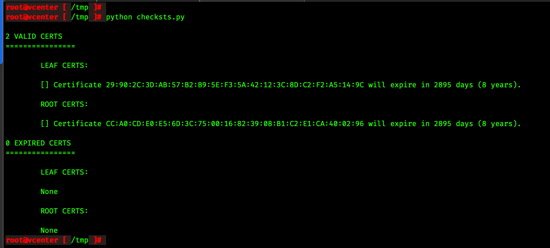

    Thank you both for your help.
    This is the output from checksys.py,  looks like the STS certs are valid.
    I’m sorry, I should have mentioned this earlier.

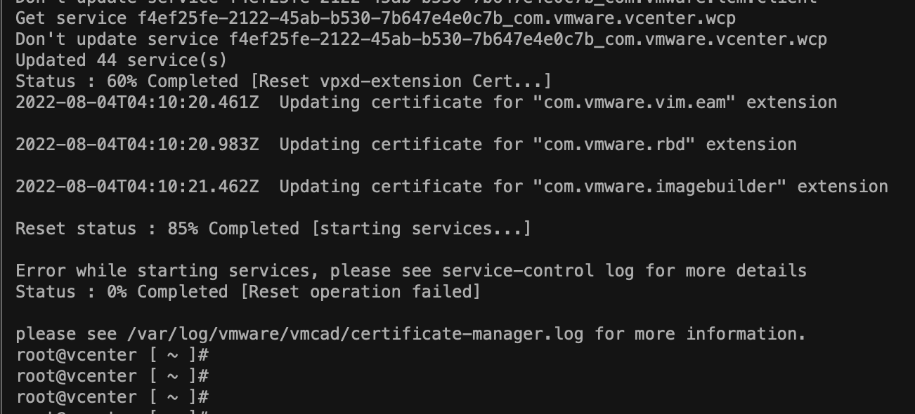

    After I fixed the log partition out of space the errors persisted. At that time on August 4, I realized the Machine Cert had expired. At that time I followed the doc below
    https://kb.vmware.com/s/article/2112283
    I did receive an error during that process. The log \ error is below.
    The service-control.log from that time period is below.
    I'm uploading the certificate-manager.log to this message.
    Again, I really appreciate your assistance.
