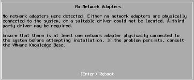

    When I try to reinstall I get this message:
    So I can't see how I can reinstall it as the only option is to reboot....
    The server is one I've built myself - what details would you like to know?
    The network card is definitely supported - ESXi installed with it perfectly fine yesterday.

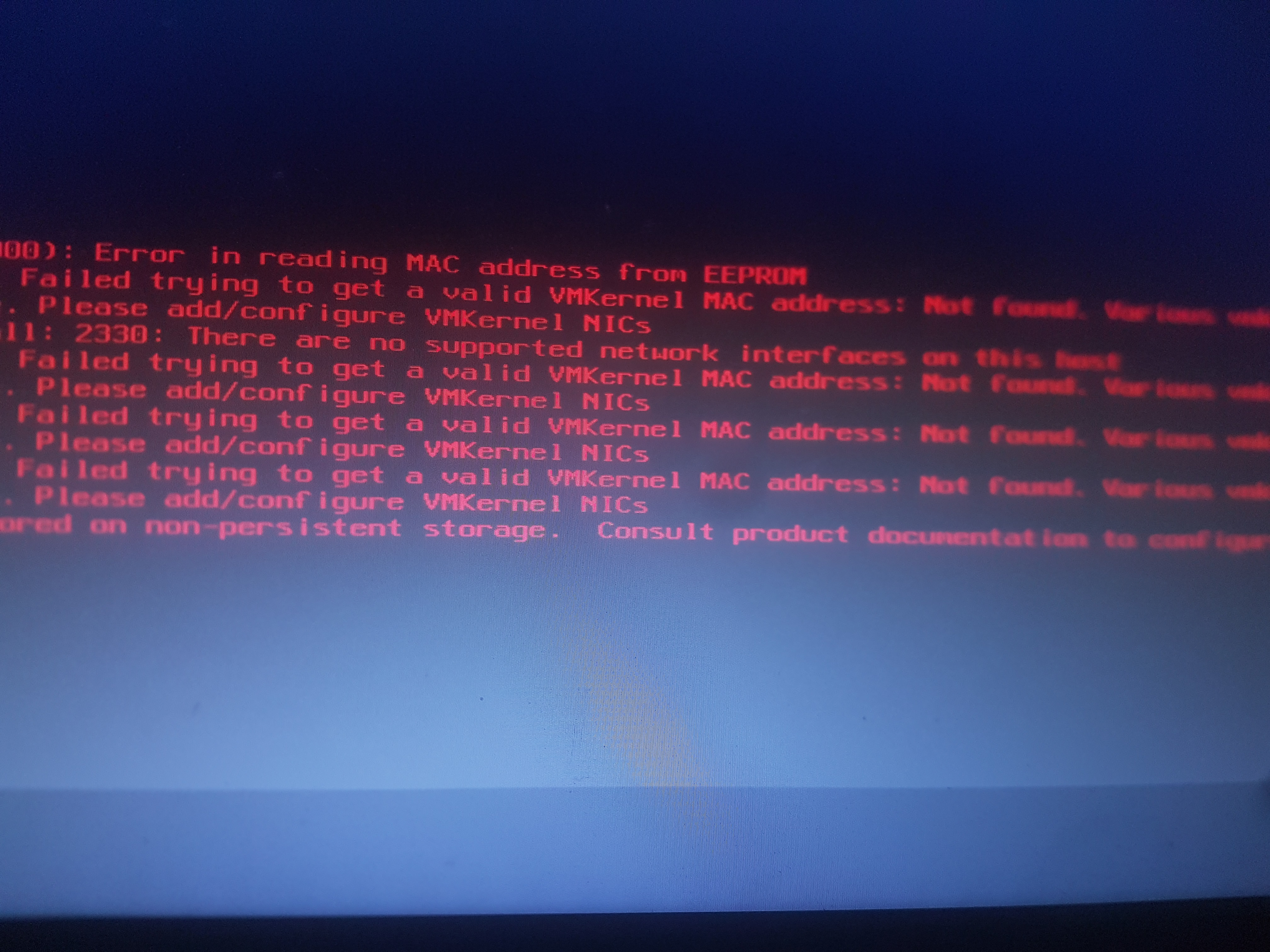

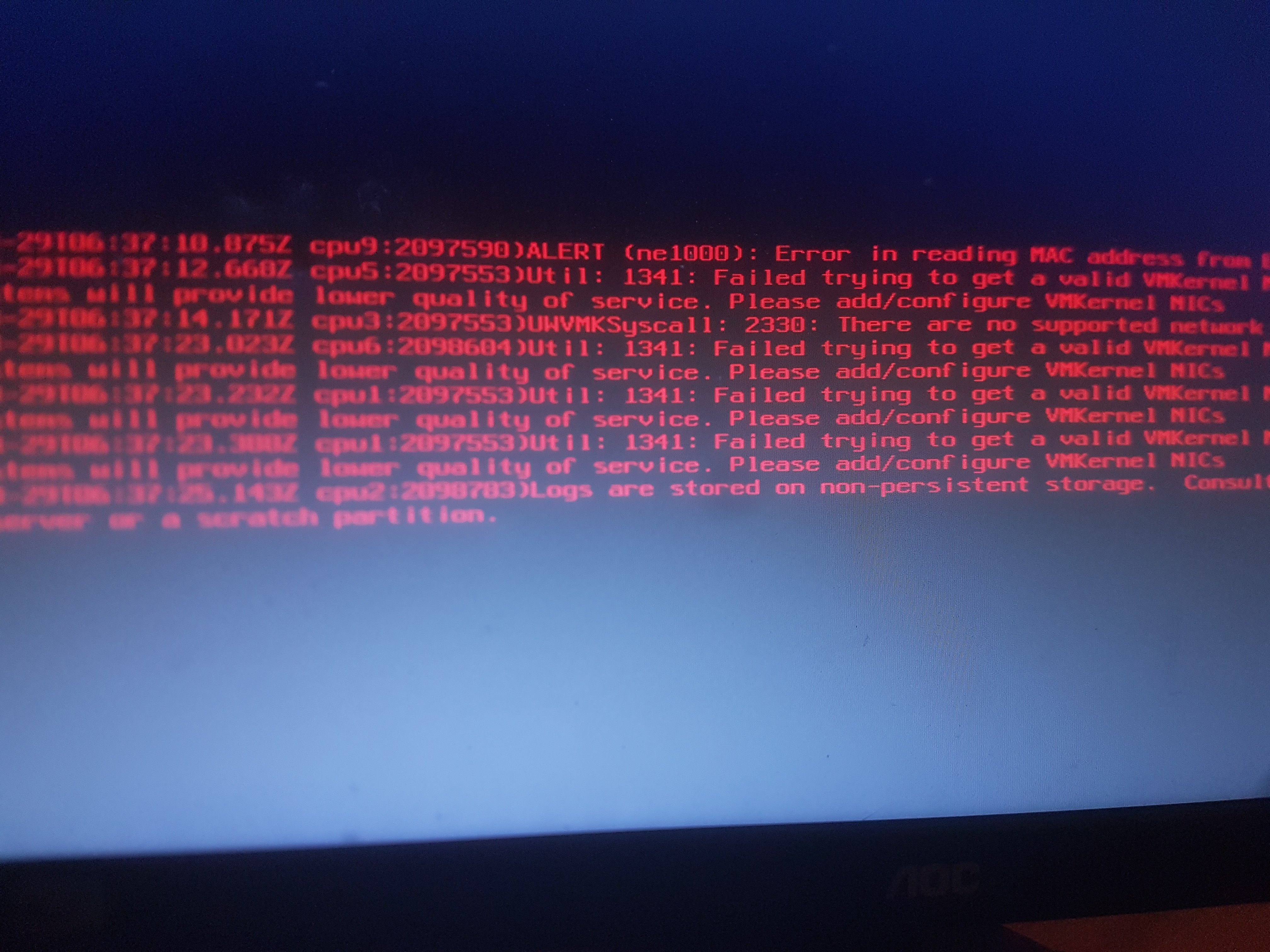

    Further to this, just before the box appears with the 'no network adapters were found' message there was a flash of red text, which was too quick to read, but I manaaged to take a picture of:
    Does that give a clue as to what is going wrong?
  • 17.  RE: No compatible network adapter found
    Posted Aug 29, 2019 02:01 PM
    Looks like the driver is unable to read the MAC info from EEPROM. I know it was working before, not sure what went wrong when the server was abruptly went down.
    Check the card health state.
    Update firmware
    Try installing the OS again and check.
    if possible, add this card on another server and check if it works well there.
