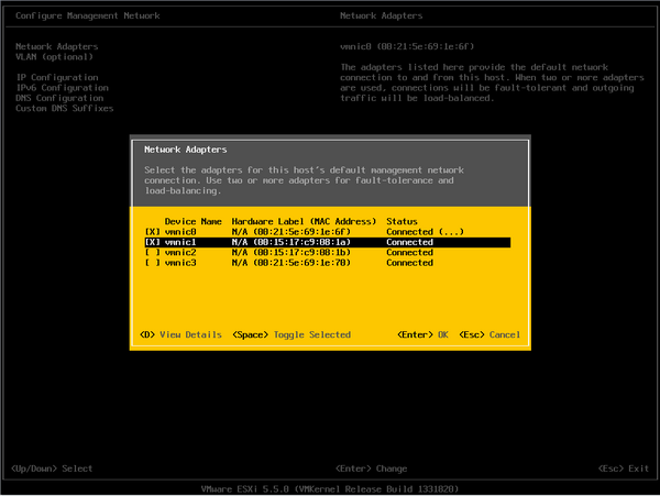

    I have installed ESXi 5.5 but the issue is that I have fallen at the next hurdle because I am unable to achieve network connectivity. In the management console the NIC says that it is connected, but it ends up with a self-assigned IP address. If I manually assign an IP address, I am unable to ping other devices on the network.

    Any VLANs configured on ESXi or Netgear?
    How many NIC/vmnic are detected?
    Make sure you are connecting to the correct vmnic#, connect 1 NIC first if you have multiple NICs.

    There are two NICs detected which is the correct number for the mainboard in the SZ87R6.
    I am connecting the correct one (vmnic0); it makes no difference if I connect one or both - no IP is ever assigned.
