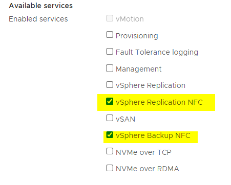

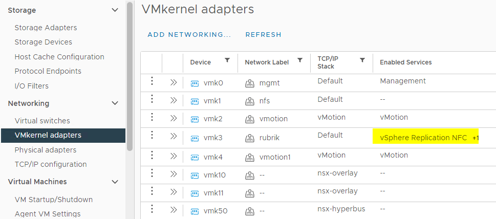

    Posted May 08, 2023 03:09 PM
    During the upgrade process, go to the vmkernel adapters of the hosts, search for NFC in the "Enabled Services", might be similar in 6.7 and then uncheck  "vSphere Replication NFC". I think vSphere Backup NFC is used in esxi 7.x, not available in 6.x
