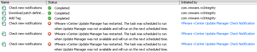

    Any ideas why I would see like 30 tasks in my vCenter console showing "check new notifications" with a status of Queued? See screenshot.

    Probably VUM?

    Posted Aug 25, 2010 05:16 PM
    What does VUM stand for?
  • 4.  RE: New vCenter 4.1 server has "check new notifications" task queued a lot
    Posted Aug 25, 2010 05:18 PM
    VMware Update Manager. You have it installed in your environment, and if so, did you update it when you updated vCenter?

  • 13.  RE: New vCenter 4.1 server has "check new notifications" task queued a lot
    Best Answer
    Posted Aug 25, 2010 05:58 PM
    I'm pretty sure it has something to do with VMware Update Manager. As you can see in your screen shot it shows a queued item for "download patch definitions" I would try and restart your VUM service and see what happens.
  • 14.  RE: New vCenter 4.1 server has "check new notifications" task queued a lot
    Posted Oct 18, 2010 08:31 AM
    Had the same problem and found this post, but still no solution to the issue.
    What did work is:
    Be sure all you clients are updated to the latest build of vSphere Client.
    The Client download link on thevSphere webpage can point to an older build of the Client.
    So download the latest build from VMware.com and replace this "VMware-viclient.exe" with the one you downloaded. (rename needed)
    Located @ C:\ProgramData\VMware\VMware VirtualCenter\docRoot\client
    This resolved the issue in our enviorment.
    I hope this helps some people resolve the same thing...
  • 15.  RE: New vCenter 4.1 server has "check new notifications" task queued a lot
    Posted Nov 30, 2010 10:34 AM
    I had this other day, tried all sorts restarting the VC adn VUM services etc etc
    In the end I went into the VUM configuration settings and just changed the notification schedule. This killed all the outstanding queued tasks and the next one completed all OK. FIngers crossed this problem is now solved. It was getting very annoying with so many stuck in the task list
  • 16.  RE: New vCenter 4.1 server has "check new notifications" task queued a lot
    Posted Jan 11, 2011 06:16 PM
    I've had this happen in our 4.1 environments as well.  It doesn't happen very often, but when it does, I'll see around 30 of these tasks queued up but they all error out as soon as I log into the server with the vSphere Client (w/VUM plugin enabled).  Just happened the other day actually.  It is almost like that "check new notifications" task can only be completed when someone with the VUM plugin enabled is connected to the vCenter/VUM server.  So when none of our admins are connected, it may be queuing up, but as soon as one of us connects and the next scheduled check hits, all the pending ones immediately error out and the latest check then works fine.  Weird.
  • 17.  RE: New vCenter 4.1 server has "check new notifications" task queued a lot
    Posted Feb 23, 2011 09:21 PM
    Check to make sure you have a 32bit DSN allocated for VUM.  If you did setup VUM on a 64bit DSN and don't have a 32bit DSN setup you would have VUM errors upon logging in though.  This combination could occur if you setup a 64bit DSN for VUM pre upgrade and then deleted the 32bit DSN post upgrade (ie, the upgrade install used the 32bit DSN and not the 64bit DSN).
  • 18.  RE: New vCenter 4.1 server has "check new notifications" task queued a lot
    Posted Mar 08, 2011 10:20 PM
    I'm getting this same issue.  Definitely agreed it resolves itself when you're logged in with a vSphere Client running the VUM plug-in.
    This is what happens when you login with the vSphere client with the VUM plug-in.  Prior to that it just hangs indicating the task is queued.
    I've confirmed the 32-bit system DSN is already setup.  I may have some authentication issues going on...  I'm going to be rebuilding this server shortly.  So we'll see if the problem recurs.
  • 19.  RE: New vCenter 4.1 server has "check new notifications" task queued a lot
    Posted Apr 13, 2011 05:19 PM
    For me, this was a simple but embarrasing fix.  Set up a new workstation for myself and had the VSphere Client installed.  Saw lots of these "check new notifications" messages in the Recent Tasks list and tried some of the suggestions such as restarting the VUM service with no success.  Then tried looking at the plug-ins and realized the Update Manager plug-in wasn't installed on my workstation...voila, problem solved :-)
