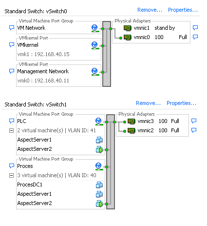

    Any chance you could share the entire HP switch config?  And a screen shot of the networking config on the ESXi box?

  • 5.  RE: Network Load balancing
    Posted Feb 06, 2014 12:35 PM
    Sure :smileyhappy:
    I am not a master at VMware, so I dont know if its the smartest setup or if there is another way which would be better.
    AspectServer1 has 2 NICs:
    192.168.40.35 (VLAN 40)
    192.168.41.35 (41)
    ProcesDC1:
    192.168.40.30 (40)
    AspectServer2 is not configured yet.
