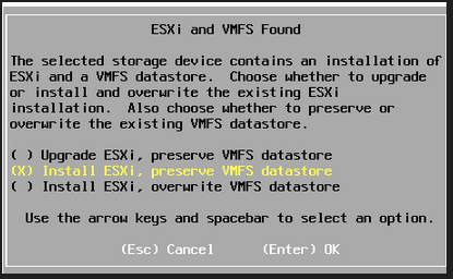

  • 14.  RE: Need standalone esxi 6.7 free license
    Posted Jul 23, 2023 04:30 PM
    Hello.
    You could try to reinstall with the option to preserve VMFS. By reinstalling you will get a demo again for 60 days.
    Remember that you should always have a full backup of your data, that means the backup of the VMs.
    Ideally you should have a logical drive for the VMware vShpere (ESXi) and another logical drive for the data.
  • 15.  RE: Need standalone esxi 6.7 free license
    Posted Jul 25, 2023 02:36 AM
    Much appreciated! That worked to give me some time to move everything. Much appreciated, that saved me a lot of time
