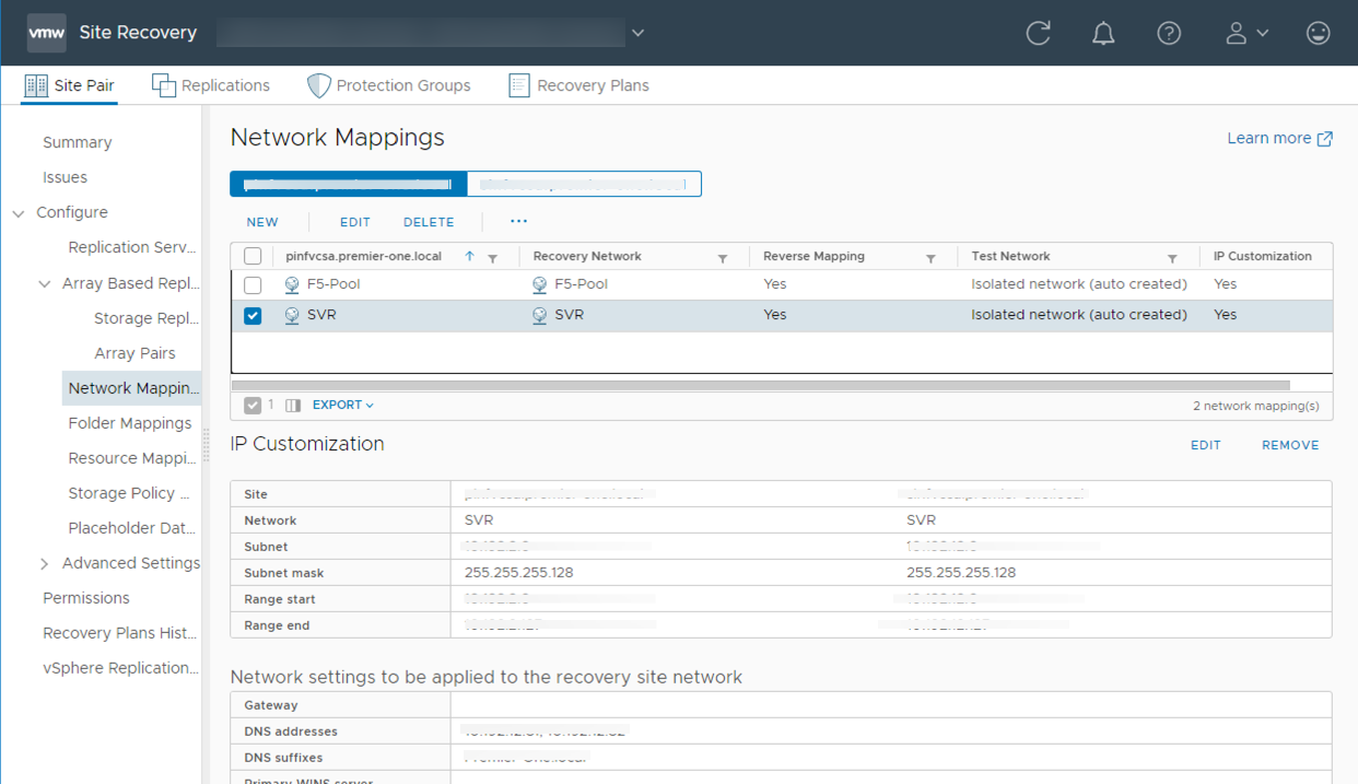

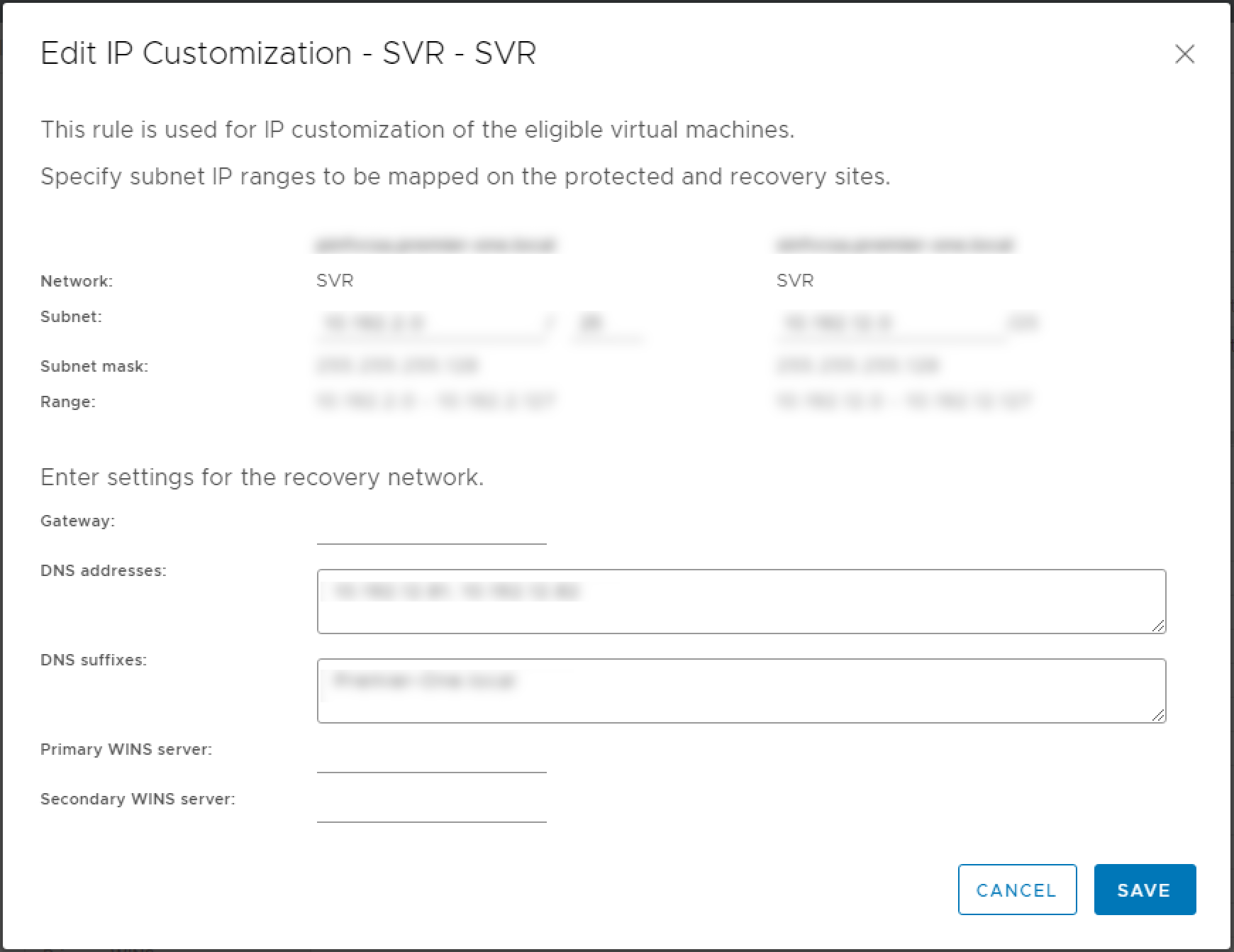

    3.. Please share a screenshot of what configurations are selected and what are left blank

    2.  I configured IP customizations at both sites, both without a gateway defined.
    3. Screenshots:
