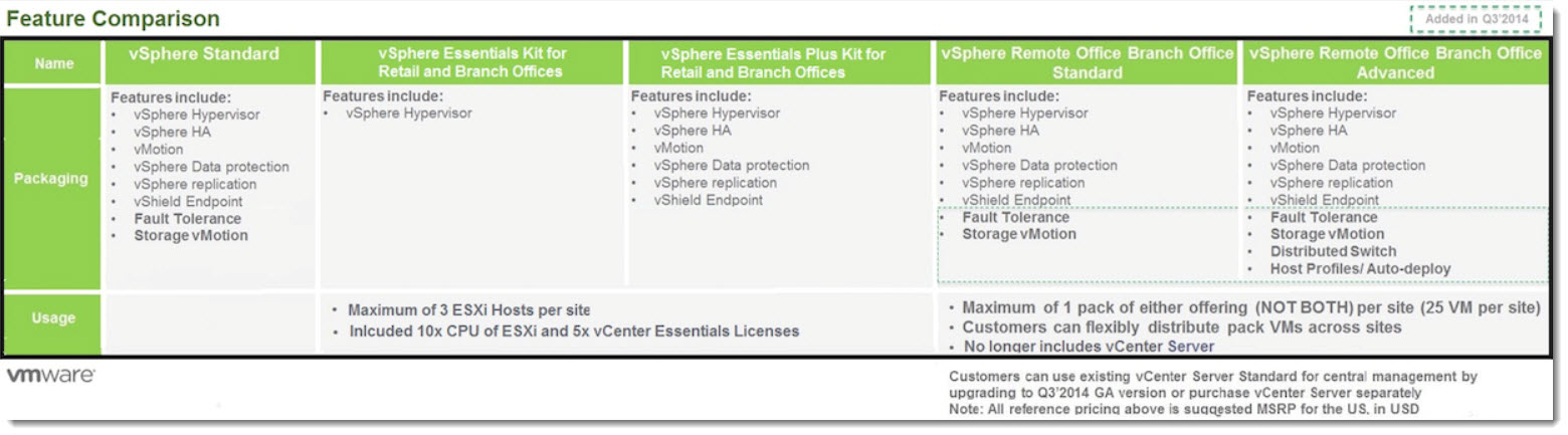

    Also back in at least 2014 there appeared to be such a limitation:
    See in the fine print there is a Maximum of 3 ESXi Hosts per site mentioned. This will likely be the information that is being gone on and was for both the Retail and Branch Office.
    Agree with TheBobkin that information received is likely not relevant now days but would still get the official word and in writing (sadly though this doesn't always help at audit time with VMware but that's a story for another day and another audience :smileywink:)

    Posted Apr 12, 2019 09:40 AM
    Again.... todays ROBO have a predecessor which wasnt a huge  "success" so VMware have re-range to Produkt to better meet the customers needs :smileywink:  The screenshot from above only covers todays ROBO and the predecessor and not the normal vSphere Essentials Bundle which costs around 460,- plus Subscription (60,-).
