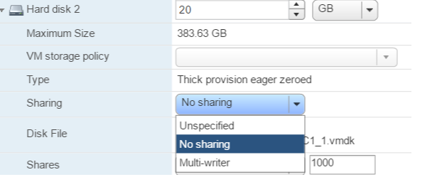

    I know this is a very old thread, but I met the same problem today.
    I am going to try to modify the vmx file directly, but I am curiously has anybody tried the other configuration on each disk?
    on ESXi 6.0 U2 host it shows
    Maybe now we can just turn on the share from UI directly ?
