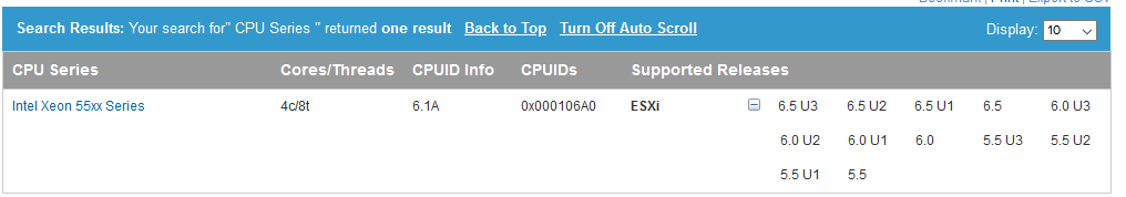

  • 9.  RE: Motherboard compatibility.
    Best Answer
    Posted Jun 10, 2020 01:33 PM
    Not only is your board not supported, but your CPU will not work with anything older than ESXi 6.5:
