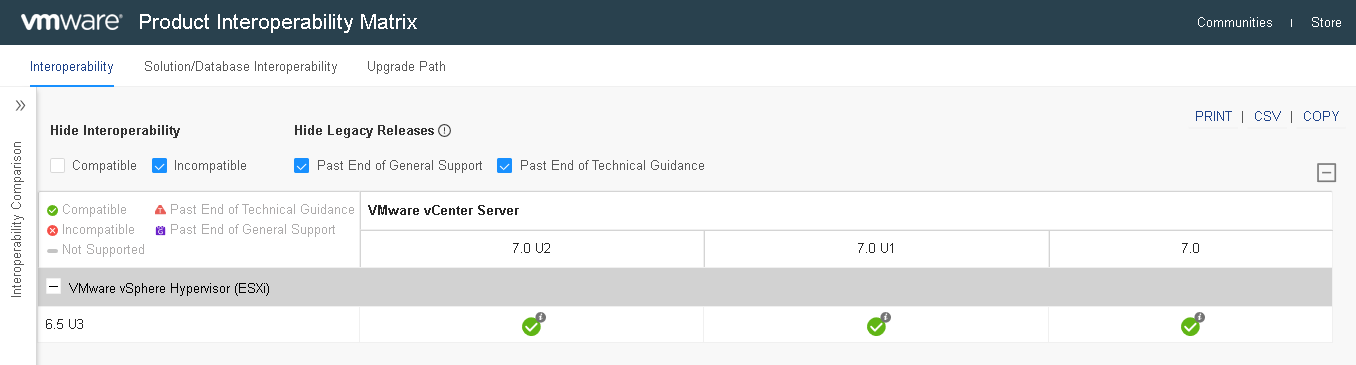

    According to the interoperability matrix with a vcenter Server 7 we can manage ESXi host in version 6.5 U3.
    Link: https://interopmatrix.vmware.com/#/Interoperability?isHideGenSupported=true&isHideTechSupported=true&isHideCompatible=false&isHideIncompatible=true&isHideNTCompatible=false&isHideNotSupported=true&isCollection=false&col=2,3496,4276,5088&row=1,3363
