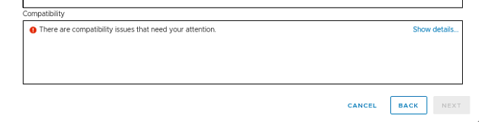

    This is what I get when I try to migrate the vCenter appliance:
    The target host does not support the virtual machine's current hardware requirements.
    Use a cluster with Enhanced vMotion Compatibility (EVC) enabled to create a uniform set of CPU features across the cluster, or use per-VM EVC for a consistent set of CPU features for a virtual machine and allow the virtual machine to be moved to a host capable of supporting that set of CPU features. See KB article 1003212 for cluster EVC information.
    CPUID faulting is not supported.
    com.vmware.vim.vmfeature.cpuid.ibpb
    com.vmware.vim.vmfeature.cpuid.ibrs
    RDTSCP is unsupported.
    1 GB pages are not supported (PDPE1GB).
    3DNow! PREFETCH and PREFETCHW are unsupported.
    XSAVE YMM State is unsupported.
    XSAVE SSE State is unsupported.
    com.vmware.vim.vmfeature.cpuid.ssbd
    com.vmware.vim.vmfeature.cpuid.fcmd
    com.vmware.vim.vmfeature.cpuid.stibp
    com.vmware.vim.vmfeature.cpuid.mdclear
    Fast string operations (Enhanced REP MOVSB/STOSB) are unsupported.
    Supervisor Mode Execution Protection (SMEP) is unsupported.
    Instructions to read and write FS and GS base registers at any privilege level are unsupported.
    RDRAND is unsupported.
    Half-precision conversion instructions (F16C) are unsupported.
    Advanced Vector Extensions (AVX) are unsupported.
    XSAVE is unsupported.
    AES instructions (AES-NI) are unsupported or disabled in the BIOS. See KB 1034926.
    POPCNT is unsupported.
    MOVBE is unsupported.
    SSE4.2 is unsupported.
    SSE4.1 is unsupported.
    PCID is unsupported.
    FMA3 is unsupported.
    Carryless multiply (PCLMULQDQ) is unsupported or disabled in the BIOS. See KB 1034926.
      hostname
      The vMotion interface is not configured (or is misconfigured) on the "Source" host 'hostname'.
      hostname
      A general system error occurred:
    The IP address family of source vMotion nic (IPv6) does not match the destination (IPv4). If you proceed with the operation, there is a high likelihood of operation failure.
      hostname
  • 6.  RE: Migrating a vCenter Appliance to a Cluster
    Posted Nov 05, 2019 11:26 PM
    Can you show what you have or describe in detail? What you've posted suggest you have EVC enabled and that you have a host without vMotion enabled.
