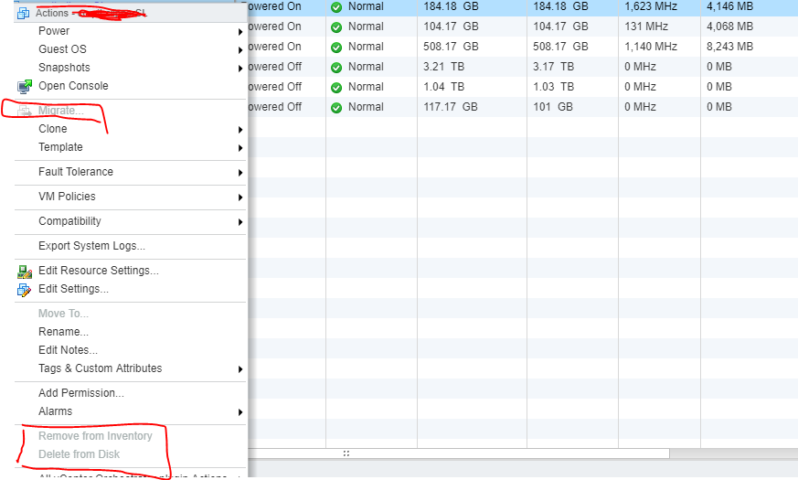

    I have several host in cluster a vMotion work . but now I need to remove some VM on another host and migrate option is grayed out , option remove from disk and remove from inventory are also grayed out.
    Vmotion work because I have migrated some VM already to other hosts. there are no running task , snapshots are removed .
    Is anyone have an idea what can be a problem?

    Can you show screenshots?

    Posted May 29, 2019 12:11 PM

    Please check this KB VMware Knowledge Base
    This could be due to the disabled methods not properly removed from vcenter database.
    Note : Please ensure to have backups of your vcenter before modifying anything from database

    ok, but vm is up end running . I didn't try to power off and then do migration.

    Kb still applies.. :smileyhappy: Please try to check in the database for the VM in vpx_disabled_methods if there is any entry

    Delete/remove options are grayed out when a VM is powered on and is expected behavior. You cannot remove the vm or delete vm when the respective process is running.

    I shutdown VM ( although I'm not allowed to do it)   and then I had option migrate. most stupid solution workout .
    I will try kb . Now I must :smileyhappy:. Thanks all for support.
