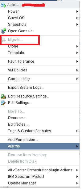

    Hi All,
    I'm trying to migrate one of the VM's to the different data store but migrate option is showing grayed out. All other VM's are fine.
    Thanks

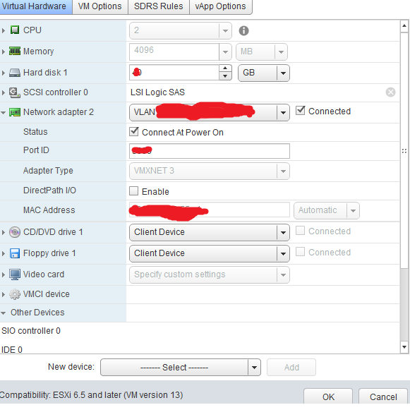

    Is it possible the VM is using something not available on another host, like the port group it is using? Or it is tied to a host by having PCI or USB device passthrough set, or even connected to a disk in the hosts optical drive?
  • 3.  RE: Migrate option in VM is grayed out
    Posted Mar 06, 2019 07:01 AM
    Actually there are 2 VM's and both have the same VLAN and no PCI, no RDM.
    thanks
    vmk
  • 4.  RE: Migrate option in VM is grayed out
    Posted Mar 06, 2019 09:59 AM
    The "VLAN" selected exists on the destination host?
    The hard disk is not a RDM?
    Does the VM have snapshots?

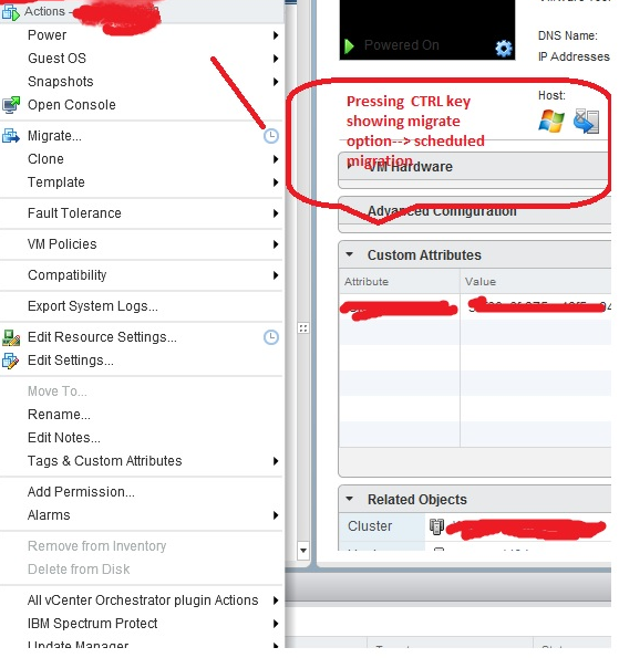

    Posted Mar 13, 2019 05:10 AM
    It's weird that if we press a ctrl key it will show migrate option which is scheduled migrate option.
    thanks
    vmk

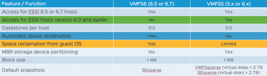

    Posted Mar 13, 2019 06:45 AM
    Does "MBR storage device partitioning" have a bearing on this problem?
  • 25.  RE: Migrate option in VM is grayed out
    Posted Mar 13, 2019 10:19 AM
    No it doesn’t. VMFS versions before this used MBR and hence the restrictions to 2TB. VMFS5 volumes that are MBR will change to GPT once extended beyond 2TB but would not impact Storage vMotion in this way.
