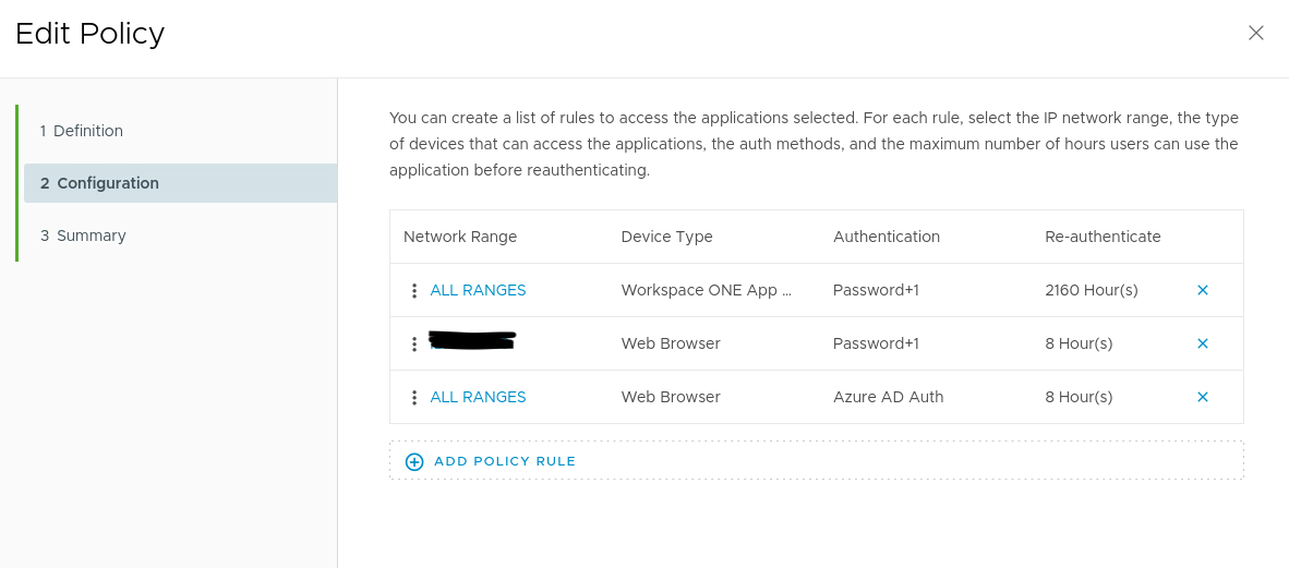

  • 7.  RE: MFA in onprem vRealize Automation 8.x
    Posted Mar 13, 2023 08:49 PM
    So I created a separate policy, and that didn't seem to work.
    But following the directions in the blog; and then adding to the default policy, a special management network, that uses the original Password / fallback Password (Local Directory).  It works.
    From the special management network, it uses normal auth method and you can login as the admin account you created at install; or you can change domain to use local AD.
    From anywhere else, when you click login, it goes out to Azure AD requiring MFA.
