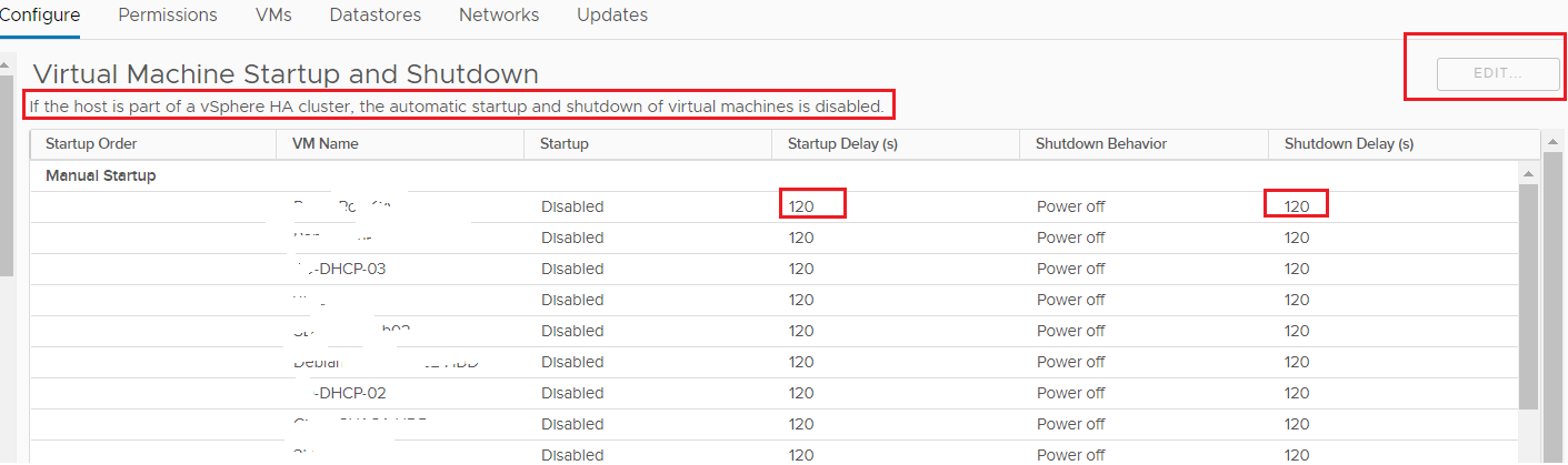

    Not so long ago, we faced an unplanned power outage in the office, and therefore did not have time to correctly transfer the ESXi hosts to maintenance mode, which in turn are part of the vCenter Server in HA mode. After power-up, not all VMs were able to start correctly, and as a result, they had to be started manually. The official manual states that hosts and VMs located in the HA cluster do not support the autorun function and setting this mode, and by default turn on/off after 120 sec.
    Tell me how then you can configure VM autorun for critical IT services on ESXi hosts, either this is done according to some HA algorithm, or it is impossible, and what are the recommendations for this mode of operation in the HA cluster ?
    1. Let's say we have three ESXi hosts in the HA cluster, after enabling three hosts and after 120 seconds. start all VMs, - will all VMs start on the same ESXi host on which they were shut down ? We have a part of the VM that did not start and ended up on other ESXi hosts.

    The Virtual Machine Startup and Shutdown (automatic startup) setting is disabled for all virtual machines residing on hosts that are in a vSphere HA cluster. Automatic startup is not supported with vSphere HA.https://docs.vmware.com/en/VMware-vSphere/6.7/com.vmware.vsphere.vm_admin.doc/GUID-7A132146-2779-4F4B-B39D-EE4F129DB79C.html
    I mean, I need to be sure that, for example, the Domain Controller and DHCP services will start first, Excahnge second and a little later in time, and then the rest of the services.
    Or are there no such settings for delaying the startup time of VMs in a high availability cluster, but only the settings for restarting VMs on other hosts? But I don't need some VMs to start themselves, as I don't have enough system resources if all of a sudden the VMs are consolidated on two of the three hosts. Or just disable HA on the host ?
