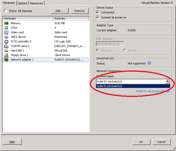

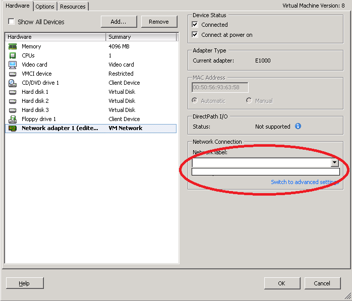

    The host added through VMware vSphere Client
    The host added through VMware vCenter.

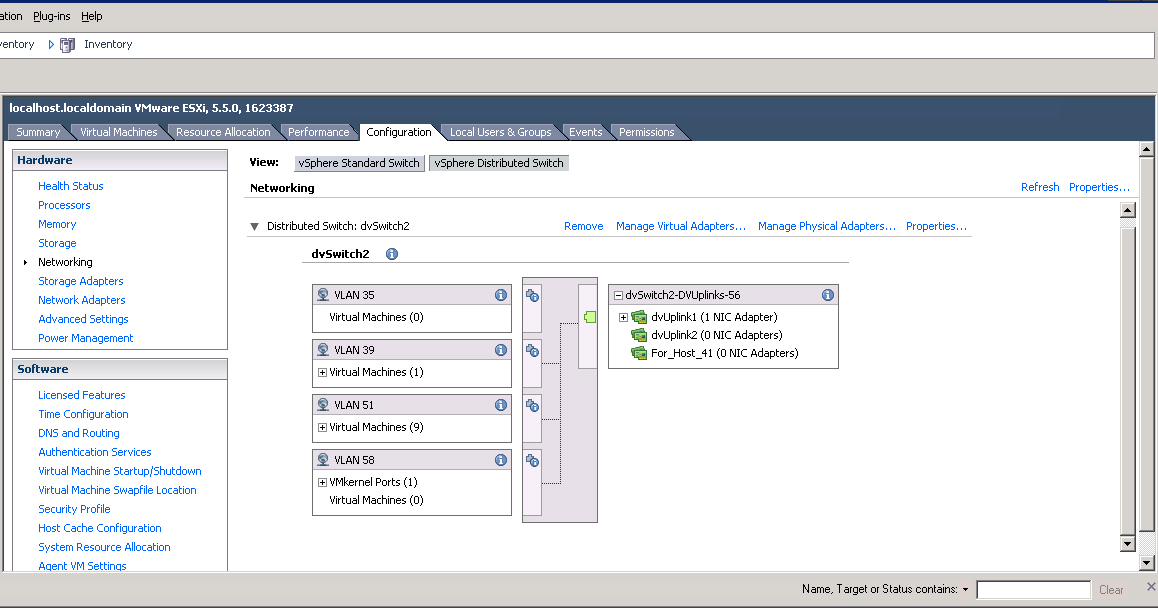

    dvSwitch settings

    Kindly ensure you are connected to the vCenter server and add the host to the vDS under Networking tab. Add the host to the existing vDS and then try to add a NIC card in the VM. If the VMs of newly added host are under a standard switch ensure to migrate the management network and then migrate the vm networks otherwise the host will become not reachable.
    As per the screenshot it seems like the host is not added to the vDS in the vCenter.
