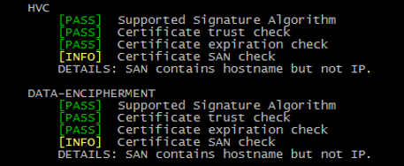

    STS Certificate not expired.
    Diagnostic tools showed these errors:

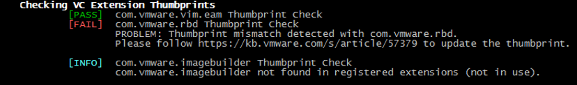

    And now I have new question.
    How resolve problem on screen 2. KB isnt usefull.
    LDAPs I dont use.
