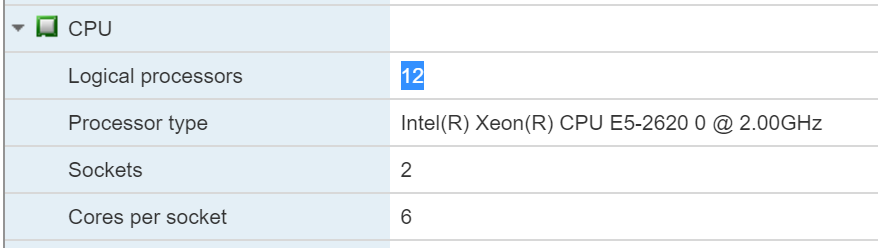

    I have an intel S2600CP2 system board with 2 Intel E5-2620 processors.  I have hyperthreading enabled in the BIOS.  Since the processor is hyperthreaded, I would expect to see 24 logical processors (2 processors * 6 cores * 2 hyperthreaded = 24 Logcal procesors?) but when I look at my ESXi CPU configuration I only see 12 logical processors.  Is this right?  If not, does anyone have any thoughts on why it is only seeing 12 logical processors and what I need to do to correct this?

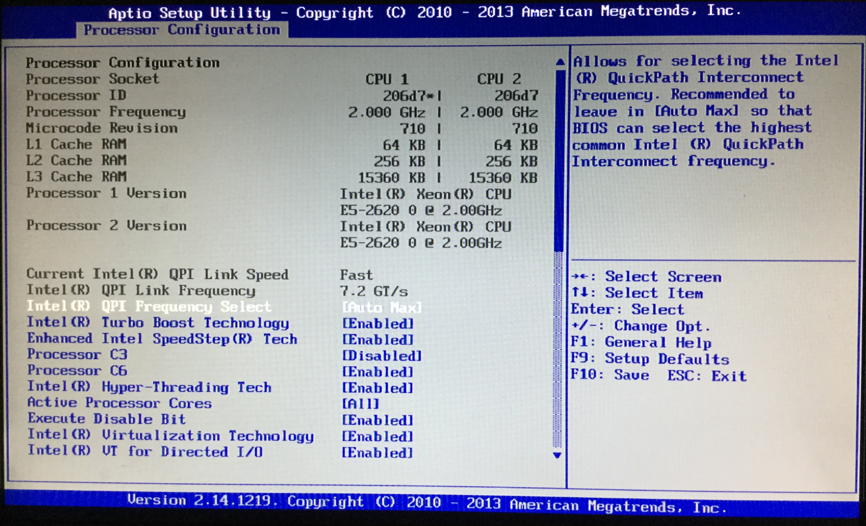

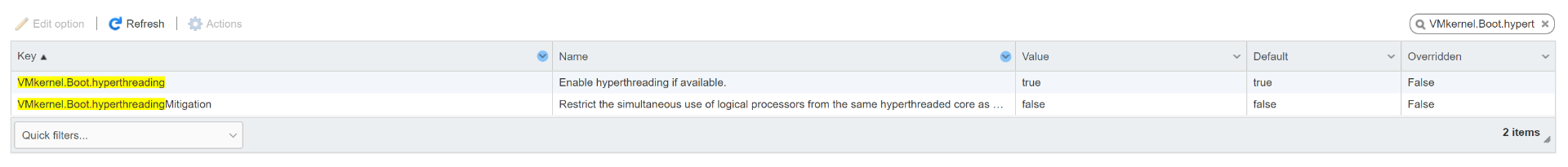

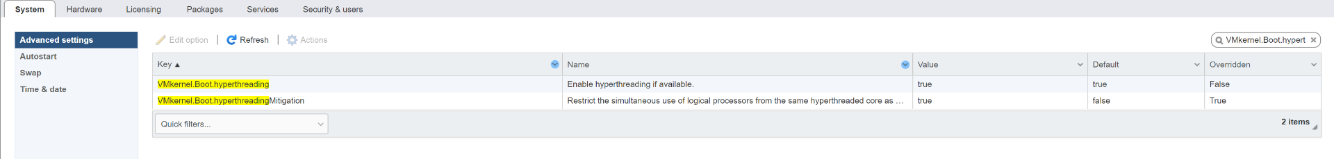

    Here is a screenshot of the VMkernel.Boot.hyperthreading setting and a photo of my bios setting.
    I don't know if this matters or not, I tried searching and couldn't find anything about this, I'm running the free version of esxi.  Would that cause this issue?
    Thanks again for any help

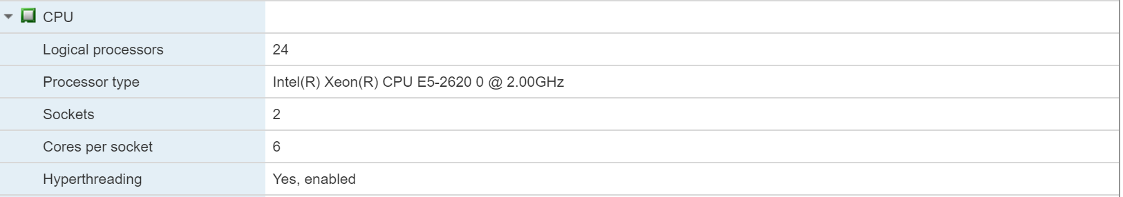

    I figured it out thanks to the hint from sjesse​.
    At some point in the past I must have overridden the HyperthreadingMitigation flag.  I noticed that as I was posting the prior message with the screen-shots.
    I have reverted that flag back to false (the default setting), rebooted the server, and now I see 24 LogicalProcessors
