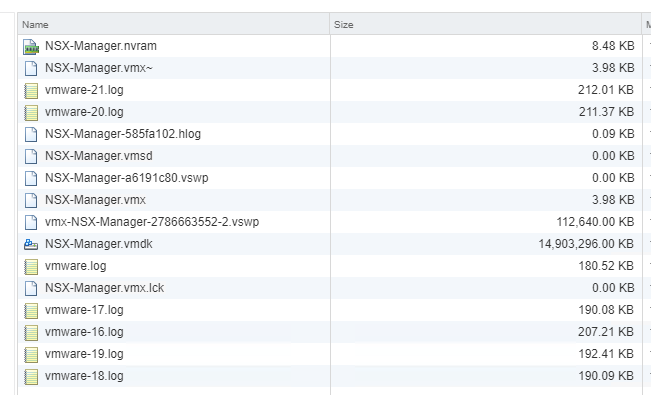

    I had a storage failure today in my test environment and 4 of my VMs are showing as inaccessible and they have .lck files in the folder on the datastore. Since this is a test environment I don't have backups of these VMs so is there anything I can do to save these VMs? Before anyone mentions it, I have tried the VMware KB articles on locked files and have Googled this to death but clearly I am missing something!
    This is how they look in vCenter:
    And this is the folder contents of the VM:

    If the problem now is just the .vmx file with lock, you can create a new virtual machine and point to the old .vmdk.
  • 5.  RE: Locked files in VMs after storage failure
    Posted Nov 08, 2017 09:12 PM
    I have tried deleting the lock files and creating a new VM and pointing it to the vmdk but neither worked.
