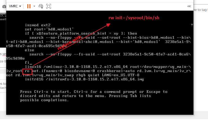

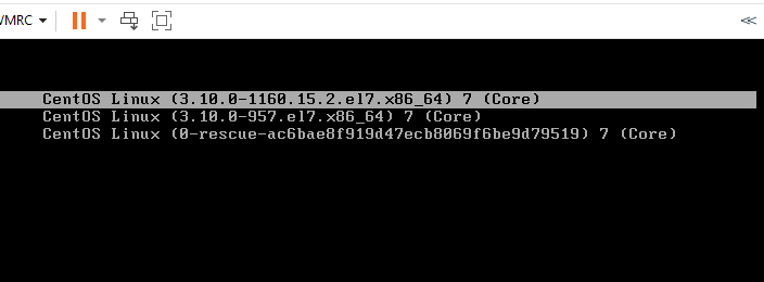

    You need press E key when see this screen
    After this edit the correct line to enter in single user mode.
    For example on Centos OS  you need replace the "RO" whit "rw init=/sysroot/bin/sh" and after press F10
    when you have a prompt mount filesystem root with this command
    chroot /sysroot/

    Thank you fabio1975
    I am not getting the Grub screen. As I noticed If I press and hold the "Shift" key then I get the Grub screen but not in my case.
