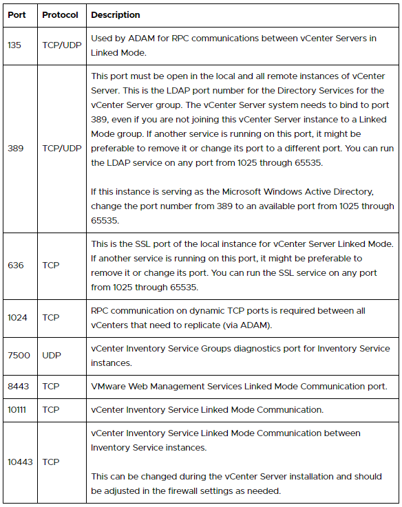

    My question is if anyone has a better list of required ports between both vCenter servers?
    I had opened the required ports for vCenter 6.7 Linked mode according to a vSphere document with the ports listed below, but I still got a failure when running the domain-repoint command until my colleague opened the firewall completely for testing purposes. I need to know the exact ports. I tried netstat on vCenter but wasn't effective for determining the vc to vc communication during time of installation. You'll notice 2012/2014 isn't in the list as I think that was deprecated in the later vCenters. Any ideas?
    135 1024 389 7500 636 10111 8443

  • 5.  RE: Linked mode port requirements for Firewall?
    Posted Mar 20, 2020 05:29 PM
    Thanks Bewe but that's the diagram I actually used to make the firewall rules. You'll see that it leaves out 10443 which I found in another document here and shown below. VMware Knowledge Base
    And as you can see in our diagram, there's also no arrows going to the external SSO example they have making me think 6.x doesn't need 2012 and 2014 etc as it says vSphere 5.x only plus this is just for internal communication and I'm all embedded.
  • 6.  RE: Linked mode port requirements for Firewall?
    Posted Mar 23, 2020 03:10 PM
    Thanks Bewe that diagram actually showed the ports I was missing. I was focusing on Linked mode but didn't realize it requires SSO ports in order to rejoin into the new domain.
  • 7.  RE: Linked mode port requirements for Firewall?
    Posted Mar 20, 2020 03:23 PM
    Following are the ports need to open in firewall.
    8443 TCP vCenter Server Linked Mode
    10111  TCP  vCenter Server vCenter Inventory Service Linked Mode Communication
    636  TCP    vCenter Server Linked Mode, this is the SSL port of the local instance.
    902  TCP    vCenter Server ESXi 6.x vCenter Server system uses to send data to managed hosts. This port must not be blocked by firewalls between the server and the hosts or between hosts.
    902  TCP/UDP vSphere Client ESXi 6.x vSphere Client uses this ports to display virtual machine consoles.
    7500 UDP vCenter Server vCenter Server Linked Mode, Java Discovery Port
    135 TCP vCenter Server vCenter Server Linked Mode
    389 TCP/UDP vCenter Server Linked vCenter Servers .This is the LDAP port number for the Directory Services for the vCenter Server group.
    The vCenter Server system needs to bind to port 389, even if you are not joining this vCenter Server instance to a Linked Mode group. If another service is running on this port, you can run the LDAP service on any port from 1025 through 65535.
