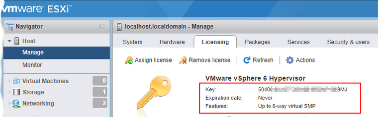

    Hello.
    First of all VMware vSphere licenses are perpetual (they do not expire).
    In the license status you can confirm it (expiration date:  Never), this means that it will continue to work.
    What expires is the subscription and support contract. If the contract expires you will not be entitled to new versions, nor to direct support with VMware.
    For a production environment it is always recommended to have a valid subscription and support contract.
