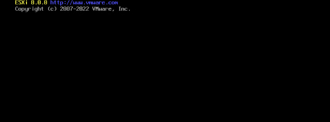

  • 5.  RE: Kickstart File Not Working
    Posted Feb 14, 2023 05:30 PM
    Hi,
    Thanks for replying!
    Basically the server is completely installed, and when I enable the ESXi Shell, it get stuck like this forever:
    I am using esxcli commands in my KS script:
    Do I need to change something?
    And I'm trying to test with a nested but having issue with that at the moment, so working with a physical server...
  • 6.  RE: Kickstart File Not Working
    Broadcom Employee
    Posted Feb 14, 2023 08:36 PM
    How are you enabling the ESXi Shell? I don't see that in your kickstart ... and by default, both SSH/ESXi Shell is disabled by default and the screen you're showing is expected.
    You would need the following (enable AND start service) for SSH and/or ESXi Shell
    # enable & start SSH
    vim-cmd hostsvc/enable_ssh
    vim-cmd hostsvc/start_ssh
    # enable & start ESXi Shell
    vim-cmd hostsvc/enable_esx_shell
    vim-cmd hostsvc/start_esx_shell

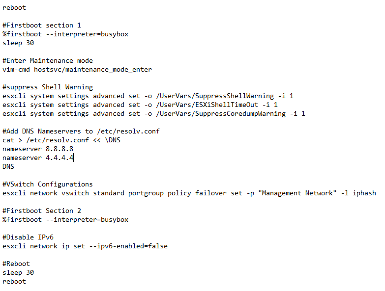

  • 7.  RE: Kickstart File Not Working
    Posted Feb 15, 2023 01:44 PM
    Hi,
    So I connected to the ESXi GUI and tried to enable them, but they keep failing after I start them, need to investigate,
    I think something with the script is messing it up,
    When I deploy the ISO without any KS script, they can be manually started, when using the script, they keep failing.
    I'll make some trial and error with the KS to see which lines are causing the issue...

  • 8.  RE: Kickstart File Not Working
    Posted Feb 21, 2023 01:49 PM
    OK, I figured out the problem with the ESXI Shell and SSH,
    For some reason, when using the Kickstart script, the timeouts are set to 0,
    This is causing the services to start and immediately stop,
    After changing the timeout they started working.
