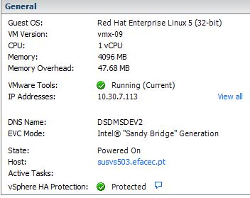

    Yes, you are correct. ESX 5.1 and I have tried the conversion to both WS 7 and Player 5. Here is some info about the machine that  is being converted:
    It has one SCSI hard disk.

    ESX 5.1 supports hardware version 9, while WS 7 - i think hw version 7. The only meaningful difference I can think of is LSI Logic SAS support but IIRC it should be supported by hwv 7 too. Check with a newer player just to be on the safe side.

    So I think I have found a difference with this machine as opposed to others that will export just fine with hardware version 9. The one that is having issues, the SCSI controller is set to Paravirtual, while the other machines that export fine are LSI Logic SAS. Would Paravirtual prevent the machine from booting once exported?

    That's quite possible. Converter has created the destination VM with LSI Logic controller (if i am not mistaken; you can check it in the .vmx file - look for scsi0.virtualDev or scsi1.virtualDev). If the source machine doesn't have driver for LSI Logic it wouldn't boot.
    You may try this the hack from this article http://v-reality.info/2012/02/paravirtual-adapters-with-vmware-workstation/ and set 'pvscsi' in the vmxl if you are lucky it may power on.
    Another way would be to do a P2V. Power on the source VM and convert it as a physical machine.
